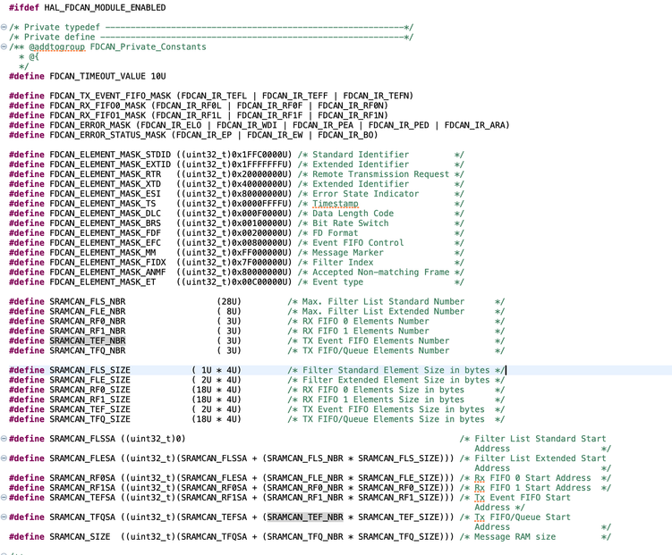

Is there a way to set the FDCAN TX and RX FIFO sizes for STM32H7R7 in CubeIDE?
I snooped around and found a list of macros that are responsible for determining the FDCAN RAM size in the stm32h7rsxx_hal_fdcan.c. Do I just modify these values to set the FIFO sizes?

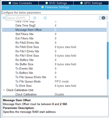

Here is my configuration parameters.

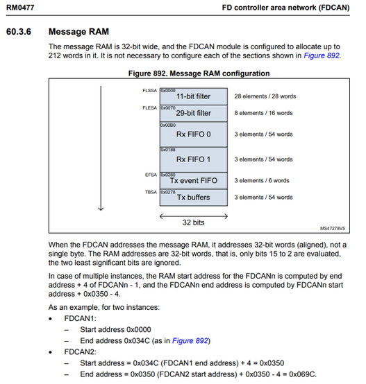

Sorry, I didn't check your STM32H7 chip, the STM32H7R7 has the reduced FDCAN controller (with only 2K Byte of Message RAM, against the 10 KByte on other STM32H7 chips) this controller has a fixed FIFO configuration that can not be modified!

You can set the Different Buffer numbers and FIFO elements in CubeMX:
Or You can make You one CANInit function (like I normaly do):

Thanks for your response. I can’t find the RAM parameters in CubeMX. Are these parameters for the STM32H7R7?
