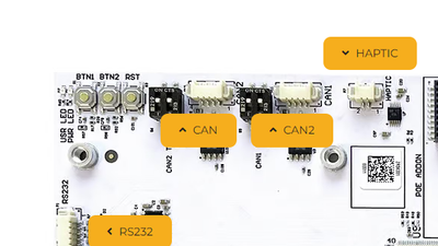

I've started to develop with the Riverdi STM32 Embedded Display and I'm trying to use the CAN BUS to display data, but unfortunately I can't. I'm not receiving any data. The CAN on the board is a FDCAN and I've set it to classic, because that's the function I need to use. I'm not receiving any data. The baud rate is set to 500kbit/s as I need it, but whatever I send to the board via the CAN BUS, I'm not receiving it. I need to receive from any CAN BUS ID. I'm also trying to find information on how to send data properly between the Main -> model. I've found some information but it's 2-3 years old and I could use a little more help.
Thanks a lot.
Frankydoody
thanks everyone, i found the problem after doing some other research, the buffer for fifo0 must be setter
hfdcan1.Init.RxFifo0ElmtsNbr = 1; // 1 is the minimum that must be for it to receive data in the FIFO0 otherwise param error and nothing enters.

Before going ahead with the code, is there a CAN transceiver on the board?
If yes, what is the node you've connected on the bus to transmit data to your board?
How did You connect CAN_H and CAN_L?
Is that possible to share your CAN schematics part? at least a diagram?
@mƎALLEm Their web page says: "Fully independent 2xCAN FDs  Applicable in industrial and automotive area."
https://riverdi.com/product/7-inch-lcd-display-stm32h7-frame-rvt70hssfwn00
i know the problem it's not hardware but more with my code so i search a solution or tutorial for FDCAN and the stm32H757 with screen
mƎALLEm
Ok since the board features CAN transceivers, (and apart of previous questions) you need also to check the two termination resistors of 120 ohm connected to the bus.
Check also the wires continuity of CAN_H and CAN_L on the transceivers' pins.

good morning,
yes, i'm very sure that it's not the hardware, but the software that's the problem. the board i use is the one from Riverdi. I tested the components that could be faulty and everything was ok. So I know and I'm convinced that my problem is software and if I can find an updated tutorial on FDCAN and touchgfx that would be perfect. All I'm trying is to receive CAN messages from a 500kbit/s CAN classic and simply display the ID on the screen for testing purposes. The code I've published comes from MX and I've confirmed that it's configured in 500kbit/s.
