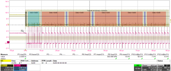

After STM32H5 I3C initialized as a controller, without any IBI, HotJoin Enabled, pull low SDA line will case SCL unstopped-toggle, as figure

Hello, @Foued_KH , thanks for your reply,
I am using demo board [NUCLEOH-563ZI] for my Hardware without connect any slave device,
I keep pin PB8(I3C1_SCL), PB9(I3C1_SDA) floating when power up, and then pull SDA to GND cause SCL unstopped-toggle, as figure above
In Legacy I2C Bus scenario, there is other Host I2C share the bus, it might be a problem.

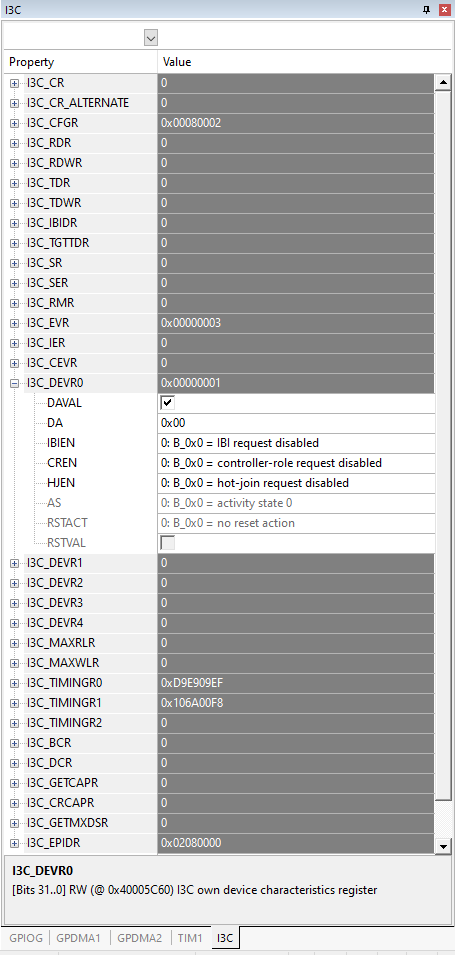

‎2025-01-08 7:14 PM
Hello, @Foued_KH
If you disable the IBI and HotJoin as well, you will not see this behavior.
I think I am not enabled either IBI or HotJoin, here is my I3C registers after initilized, did I miss something?
My recommendation is to connect an I3C target on the bus :
I am developing a I3C-adaptor , a tool of I3C, so I can't not decide the which target will be connected to the bus
