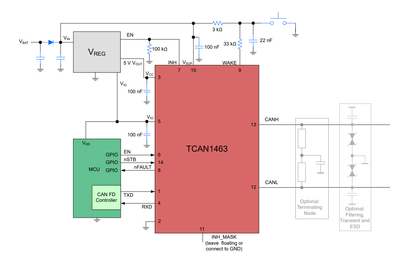

MHoll.2
Senior III
the STM32H503CBT6 has a working FDCAN controller.
To help You I need more information:
1) The Nucleo-H503RB don't has a CAN Transceiver, can You show how You connected the CANBus?
2) How is the CANBus connected on You custom board (base on the STM32H503CBT6)?

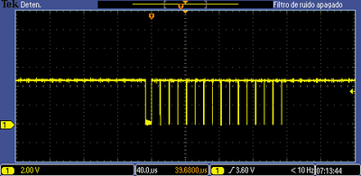

I'm using the 2 transceivers TCAN1463-Q1 of Texas Instruments, one for the nucleo board and another for the custom board, same connection.
I was able to transmit with the custom board, but the signal looks like this:
I searched and I found out that this is probably due to the TX line, but I don't know what is causing it.
Have you ever encountered behaviour like this?
I'm clousing the post because i think that the problem is in my board.
Check your HW especially the transceiver part:
Power supply (VCC), VIO pin level voltage, EN pin, Standby pin level voltage etc..:
