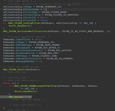

FDCAN not working with STM32U5F7
I'm using a custom board with an STM32U5F7. Written a program(with nothing else configured other than clock and FDCAN) that simply sends out a message via FDCAN (in classis mode, 500kbps) which I'm hoping to receive using a P-CAN. When probing the TX line going to my transceiver using an oscilloscope there seems to be no data being transmitted, the line is just pulled high to 3V3.
The same board populated with an STM32U599 running a new project with the same configuration and same code is able to successfully send messages which I can scope on the TX line.
With the STM32U5F7, I have tried internal loopback mode to rule out any hardware related issues (following the FDCAN loopback walkthrough on ST's YouTube) but I'm not receiving messages as well.
Not sure what to make of this or how to diagnose and fix the issue I'm facing any further than this. Any input would be highly appreciated

Hareesh_SAuthor
Sep 16, 2024 12:07 PM UTC
I have made the changes you have pointed out, including a screenshot as I think it would be easier for you to access, given that I have not changed anything else. I am still not getting any data in my RXData buffer though.
I appreciate your patience in assisting me solve my issues,
Thank you!
mƎALLEm
Sep 16, 2024 12:47 PM UTC
First, please don't use screeshots to show your code. You need just to paste your code using </> button.
Second, unfortunately I don't have a STM32U5F7 board to test.
Try to change the filter config either:
By replacing:
sFilterConfig.FilterType = FDCAN_FILTER_MASK;
by:
sFilterConfig.FilterType = FDCAN_FILTER_DUAL;
 or keeping filter mask config and replace:
	sFilterConfig.FilterID2 = 0x11;
by:
sFilterConfig.FilterID2 = 0x7FF;
