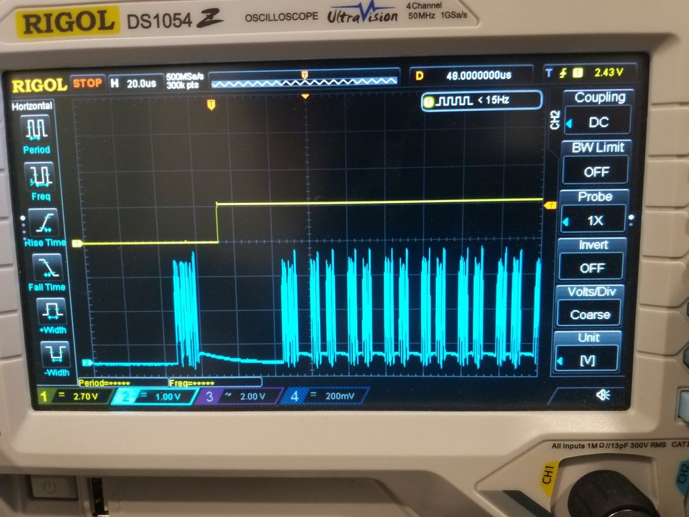

STM32F407 CDC Host - IN transaction always returns NAK
  • October 19, 2020
  • 3 replies
  • 6917 views
I've setup an STM32F407 as a CDC Host on the HS peripheral with Full Speed (FS) comms, but the IN transaction always returns a NAK and no Device data is received on the Bulk Data pipe. I used the USB Host example from ST.com (userfunction that only transmit a message when the application=ready and a button is pushed, a receive api USBH_CDC_Receive is called within the transmit call back. I also tried a while loop with just receive after sending a message).
The STM32 Host appears to enumerate the CDC device correctly (status=CDC_CLASS at end of process). The USBH_CDC_Transmit function correctly sends an OUT transaction, an ACK acknowledge byte is returned, the USBH_CDC_TransmitCallback is triggered, and everything is visible as expected via the packet sniffer.
When using the USBH_CDC_Receive for an IN transaction, the packet sniffer sees an apparently correct sequence, but the Device always returns NAK.

edits: I used the transmit callback routine to trigger my oscilloscope to catch the rx/tx line data. See attached screenshot. As you can see data packets do occur although these could be the NAKs.0693W000004KK8VQAW.jpg

waclawek.jan
October 20, 2020
It's the device which does not respond with data, but you told us nothing about it. I assume it's a 3rd party device and you have no control over it.
It may expect handshake (both directions) or line coding information before it starts receiving on its UART and then retransmitting that to the host. Or anything else.
Sniff and try to closely reproduce the sequence of events after enumeration with PC.
USB is more a collection of widely set frameworks and vague operational hints, rather than a precise and concise specification, leaving ample space for interpretation of details. You are then usually left with no option but to find out the particular implementation's idiosyncrasies by trial and error, and then cater for them.

Sorry for the delayed reply but indeed, I used a stm32 board with a STM VCP CDC device (STM32F103) to connect to the DiscoF407 board. I have sniffed the PC to STM VCP CDC device and it goes thru a lot of line coding.
Between DIscoF4 and VCP device, my linecoding api to set the line coding gives a USBH_Busy response. Get_LineCoding does work but it is always 115200 Baud.
Unfortunately ezSniffer died:sad_but_relieved_face: when I press its reset button. So ordered the more expensive Beagle sniffer. Added some more details in Pavels reply. Thanks for the advice.
