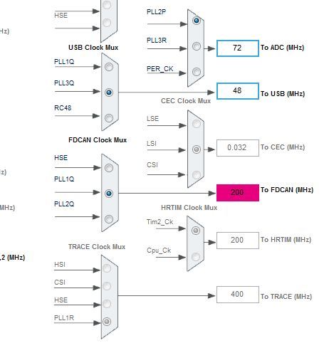

FDCAN Clock issue

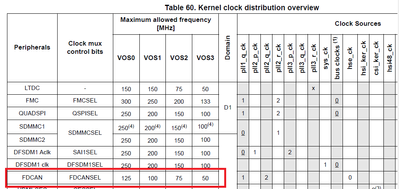

According to your screen shot it seems your MCU is an STM32H7. May be an STM32H743?
If you refer to the RM0433/Table 60. Kernel clock distribution overview:
The table provides the peripheral max clock according to the VOS level you've already set:

Hello @garry lai ,
Could you please give more details:
- Which STM32 devices are you using?
- Which STM32CubeMX version are you using?

move your mouse pointer there - a pop up will tell you the max. allowed clock
