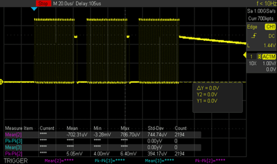

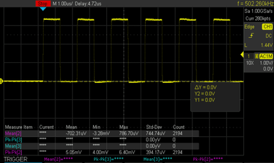

I attach some figures showing the clock signal taken with oscilloscope and all the signals taken with logic analyser.

I think the SPI clock speed is very low - possibly too low for this device.  I'd try and set it to 20-25MHz range - you only have 500kBit which is too slow to before the conversions get to the next sample.

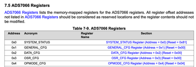

After that try and read one of the ADS7606 registers to see if it communicating ok.  There are 2 non-zero registers.  Try to read the SYSTEM STATUS register at Address 0x00, and check you get 0x81 back from the device.

There seems to be an erroneous SPI clock signal in the start of transmission.
Also on the ADS7606 data sheet there is no Register with 0x04 - the smallest is 0x08.  Can you show you SPI initialisation settings.

I think the logic analyzer is reading 0x04 because the clock starts incorrectly. What’s curious is that when I checked the oscilloscope, this erroneous behavior didn’t appear. In theory I should be sending 0x08, 0x01, 0x06 and then reading the same dares sanding first 0x10, 0x01(address), 0x00(Null). The I should receive the data on that register.

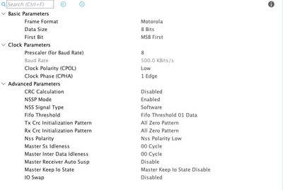

I’m attaching a figure showing my SPI initialization.
Thank you for the answer.
The I also have a Salae Logic analyser - good kit, and handy for decoding the SPI outside of the STM environment.
After SPI is initialized, do a single transfer with CS kept high. This will enable the peripheral and avoid the spurious pulse on SCK that you see in the logic analyzer plot.
