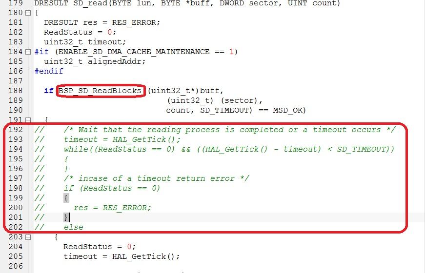

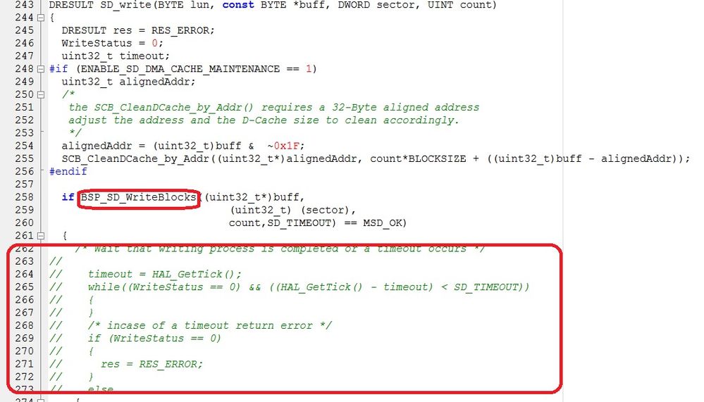

Hi!
I had a similar issue recently with the most updated versions so far Cube 4.24.0 and F4 HAL driver 1.19.0
The Cube was configured to use FATFS with SD Card and the SDIO with 4bits interface was chosen, no DMA was configured. In the sd_diskio.c file, automatically created, the code assumes that the DMA will be used (function called is BSP_SD_ReadBlocks_DMA) and there is no #ifdef to change it. So, the f_open wouldn't work due to the SD_read and SD_write function error. The solution was quite simple once identified:
Read:
And SD_write:
with only these changes, it all worked properly:
The code was tested using the Nucleo F401 and the full project is available
https://drive.google.com/open?id=1X9N9ob7u3TxycgdhRcjCDtWx8Qj-02h_
Sure I could add a #ifdef to get a better code format, but this was just a quick fix.
Hope this can help
Best Regards
