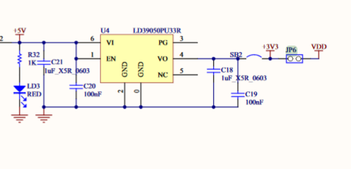

I'm measuring the current on JP6 (IDD) and I see 4mA at the lowest when running the Power_Management sample or even holding the MCU in reset. I am powering the board via the USB connector. Is this incorrect?
I've tried using SLEEP_MODE, STANDBY_MODE, and STOP_MODE defined, and they all show around 4mA

Have you disconnected everything else from the microcontroller - ST-Link, LEDs, Buttons, etc, etc, ... ?

VDD is used only for target MCU.
ST-LINK uses 3.3V directly - VDD is delivered through the JP6. So it seems that the ST-LINK current is not counted into total current consuption.
Button uses pull-up resistor (when pressed 3.3V/4.7k =0.7mA ) and LED ((3.3-1.6)/0.51k = 3.3mA) if enabled adds its current. I believe that the LED is off during the test and the button was not pressed.

‎2018-02-26 10:11 AM
The schematic shows these details:

‎2018-02-26 10:18 AM
This would be bad design....
‎2018-02-26 10:22 AM
3.3V is used for st-link, VDD for target MCU. The current flows from 3.3V toward VDD through JP6, and finally to the target MCU.

I've updated the question with the board (Nucleo-F411RE) You're correct in assuming the LED is off and the button is not pressed. I see 23mA when the application is launched (flashing LED) and 4 after going to sleep. I also see 4 if I hold the reset button

No I haven't disconnected anything. The user manual for the board indicates that simply measuring IDD should give the STM32 current consumption. Do I need to remove components? That seems like a really ineffective feature if that's the case.
