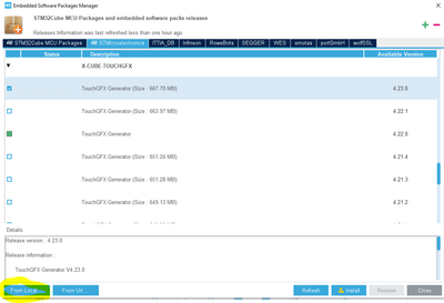

    Hello @RLarr.1 ,
    Try download and install the X-CUBE-TouchGFX manually into STM32CubeMX.
    After download the package, you need to install it by using "From local" option in the Help >> "Manage Embedded Software Packages" option in STM32CubeMX (please see the screenshot below - "From local" option in the bottom left, with yellow color).
    Then, select the X-CUBE-TOUCHGFX package (zip folder).
    Hope this works for you!

    Imen.DBest answer
    March 27, 2024
    Hello @RLarr.1 ,
    RLarr.1
    RLarr.1Author
    March 27, 2024
    @Imen.D
    Thank you.  That solved the issue with CubeMX not recognizing TouchGFX version 40.23.2.
    Both issues have been resolved.
