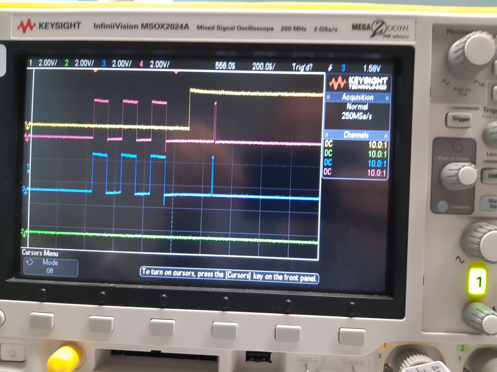

I​ use Idle Line interrupt as a timeout for UART Receive, to end up an ongoing receive process.
All in all, it works good for me, but I do have a constant issue on all the STM32, like L1, L4, H7, with a "fake interrupt upon reset". That means :
After reset I configure Rx and as result Rx pin raises from low to high and that triggers Idle line to count and that in turn means​ I will have a fake Idle line interrupt and a junk packet + Frame Error interrupt. I can filter out all the messages with FE and len=1 and I just implemented that, but I am uncertain how this solution is reliable. Do you see yet another solution on how to get rid of this 1st fake Idle line upon reset?

Wait - before you configure the UART, the RX line is low???? That means the TX line from whatever other device is talking to you is low and that shouldn't be. Unless the other device hasn't started up yet, or the serial lines are unplugged.
Next question - how does enabling the UART cause the RX line to go from low to high?
None the less, if you are sure the rising RX line (when you enable the UART) is what triggers the start of the idle timeout**(, what happens if you drive the RX pin high BEFORE you enable the UART? Actually, it should be "configure the RX line as an input with the pull-up enabled". That way, if there is nothing connected to the RX line when you start, the UART will see the RX line high as it is enabled. No rising edge, supposedly no idle interrupt.
** The L43x/44x reference manual does not explicitly mention whether an RX "idle frame" occurs only after receiving data, or if it happens ANY time the UART sees 10 consecutive "idle" bits on the RX pin. If it happens any time, then the above work-around won't help.

Please look at the attached picture.
3 red and blue pulses are just a marker that I am going to init the UART.
Yellow is the UART Rx, it raised immediately after I called the init UART function. Reading your comment I thought maybe my conclusion that the Init UART RX called this low-to-high edge is wrong and actually the device that is connected to my Rx drove the pin high while I am initiating UART was just an occasion. Tried to check that and got contradicted results and then was compelled to postpone this investigation.
You can see on the picture, that there are 1 red and 1 blue pulses that are following the yellow edge. The blue pulse is my marker on the Idle Line interrupt (IDLE Line Interrupt is set) and red is my marker on the Frame Error (FE). The time between the yellow edge and the blue pulse is about 100us which is exactly 1 byte duration @ baud 115200 bps. This is the proof that Idle line is activated upon  "10 consecutive "idle" bits on the RX pin".
Even though looking at the FE helps me to filter out this fake Idle line, I think it is worth to take your advise , if that what you advised, and to wait on the Rx line until it becomes high. Will try that.
As for the Pullup, this is a nice idea. I supposed, without checking )-: that if we select a post as Alternate, we have no Pullup configuration, but it was a mistake. GPIO can be both alternate and PU.

But GPIO pullup is only available after GPIO init. So iyou must set GPIO to pullup before uart init.
Yes, this is my intention. Thank you !​
