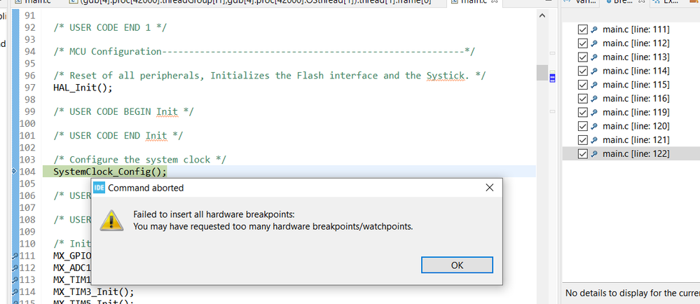

I started getting this message when I try to debug my code. However, there are currently no breakpoints in my code at all. I have gotten this in the past and I deleted and redownloaded the IDE which I really do not want to do again. I am running it on Mac. Any suggestions are helpful.

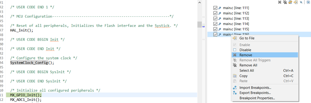

I get this error in cubeIDE when indeed i add more than 6 breakout points.0693W00000AODlcQAH.png
I can resume normal debugging when i remove breakout points down to 6

Encountered today the same problem today - no breakpoints in the breakpoint view, used brk / del debugger commands to delete all breakpoints but still no luck.
Eventually figured out that the function, where I wanted to put the breakpoint in, was likely optimised to inline and the IDE was actually trying to insert multiple breakpoints instead of one - and I only had 3 HW breakpoints available in the MCU.
If that is the case need to disable optimisation or find another way/place to insert the breakpoint.
