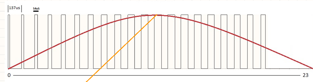

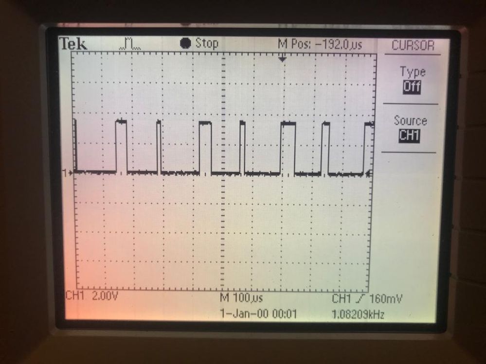

Hello ,
I have initialized two timers , Timer3 and Timer9. Im using Timer9 with 137uS period , setting my gpio pin high , starting Tim3 Interrupt with 54uS period for now .When Tim3 Interrupt occurs I simply reset my gpio pin.My problem is that I should have a high pwm for 54uS and 137uS pwm in reset state.I have thoroughly checked individual timers to just toggle single gpio in 1 single interrupt , both give me a stable 137uS pwm and 54uS pwm . But as i use two different gpio's to set and reset my gpio. I get irregular pwm that has values randomly changing. My pwm will have a constant 137uS low and a variable high pwm state which is Max 122uS for now as I said its just fixed 54uS so I also did not enable autoload preload .This is the first time I'm doing it this way.

Initially I got overconfident and defined the whole structure program which is much complicated hoping this will definitely work , but unfortunately I had to go back to the basics because I was not getting the desired Timer results.
I will add 2 photos which depict what I want and what I'm actually getting .
Any Help would be great . @Tesla DeLorean @TDK ,Can you help in this matter ?
Thanks.
Actual Picture
Original Idea

Yes , I Believe thats true but Update interrupt not interrupting in there own dedicated functions ? Weird. Trust me man I'm just trying to go along with HAL using basic libraries to get the job done ,otherwise I absolutely hate it . Will shift to LL Drivers but for now I have to get the job done .
@TDK can you help me with the above reply regarding interrupt ?
‎2023-11-22 7:15 AM
Depending on your channel configuration, CCx callbacks are done in one of the following callbacks:
HAL_TIM_IC_CaptureCallback(htim);
HAL_TIM_OC_DelayElapsedCallback(htim);
HAL_TIM_PWM_PulseFinishedCallback(htim);
You can see the logic used for callbacks within HAL_TIM_IRQHandler.
‎2023-11-22 10:07 PM
Thanks, Got it, Lastly regarding the Interrupt Priorities , I've I have 2 Timers , Timers 1 is the highest priority and Timer2 is the second highest priority , that means my Preempt Priority is 0 for Timer 1 and 1 for Timer 2 right ?
‎2023-11-23 7:28 AM
Yes. Priority 0 will pre-empt priority 1.
‎2023-11-23 8:10 AM
