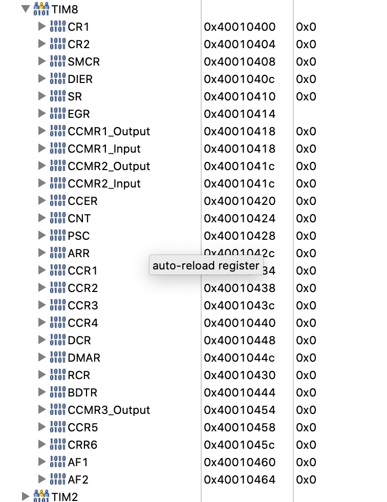

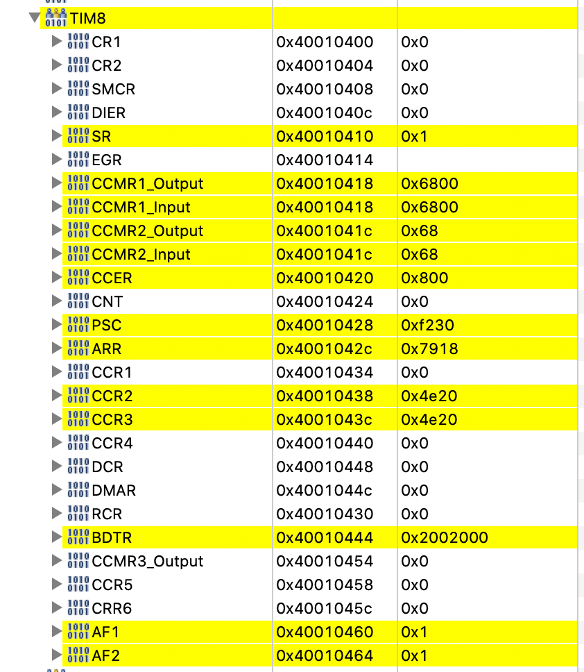

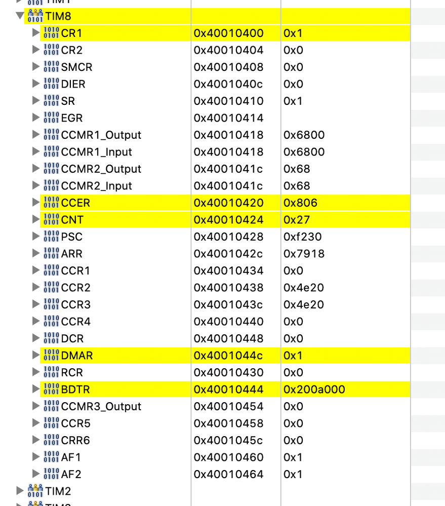

waclawek.jan
Read out and check/post content of TIM12 and relevant GPIO registers.
PS Is this intended?

So, I made three screenshots for you with TIM8.
First one before initializing timer, one after initializing but before HAL_TIM_PWM_Start, and one after HAL_TIM_PWM_Start.
Before TIM_Init:
After TIM_Init, but not started:
After TIM_init and after Start:

waclawek.jan
You have CH2 and CH3 set up for PWM, in CCMRx and in CCER you have enabled CH1N (with polarity changed for CH1) and changed polarity for CH3N - neither of CH2/CH2N/CH3/CH3N are enabled.
So this can't work.
Besides, you did not say which pins, and did not show the relevant GPIO registers content.

waclawek.jan
Basically, in the above example, you only need to set in CCER bits CC2NE and CC3NE, to enable CH2N and CH3N.
The rest appears to be OK: ARR is nonzero; timer is running as it's enabled by CR1.CEN - this is witnessed by changing CNT when observed in debugger; PWM for both CH2 and CH3 is set by setting CCMRx.OCxM to 0b110; CCR2/CCR3 are set to values below ARR; and as it's an Advanced timer, BDTR.MOE has to be and is indeed set, too.
Read the TIM registers' description in RM.
In GPIO, you will need to set the respective pins' MODER to AF and in the respective AFR register, set the required AF for them, according to the pinout table in Datasheet. This all only after you've enabled the given GPIO's clock in RCC.
You don't need to program to try this - simply change the registers directly in the debugger.
