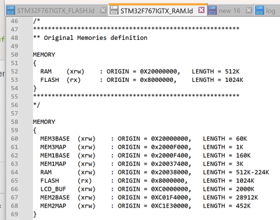

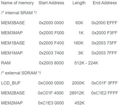

I have no previous experiences on modifying a linker script, all I learned was from STM32CubeIDE User Guide, and the following are my modifications:
address calculations for those in the following script:
/* Memories definition */
** Original Memories definition
MEMORY
 RAM (xrw) : ORIGIN = 0X20000000, LENGTH = 512K
 FLASH (rx) : ORIGIN = 0x8000000, LENGTH = 1024K
MEMORY
 MEM3BASE (xrw) : ORIGIN = 0X20000000, LENGTH = 60K
 MEM3MAP (xrw) : ORIGIN = 0x2000F000, LENGTH = 1K
 MEM1BASE (xrw) : ORIGIN = 0x2000F400, LENGTH = 160K
 MEM1MAP (xrw) : ORIGIN = 0x20037400, LENGTH = 3K
 RAM (xrw) : ORIGIN = 0x20038000, LENGTH = 512K-224K
 LCD_BUF (xrw) : ORIGIN = 0XC0000000, LENGTH = 2000K
 MEM2BASE (xrw) : ORIGIN = 0XC01F4000, LENGTH = 28912K
 MEM2MAP (xrw) : ORIGIN = 0XC1E30000, LENGTH = 452K

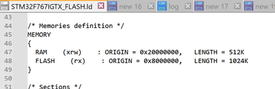

Best answer by TDK
Still think you're modifying one linker script but using another.
From your screenshot, it looks like you're using the *_FLASH.ld linker script file:
which, from your attached project, only has the RAM and FLASH sections defined.
Looks like you've modified the *_RAM.ld file, but aren't using it:
Delete the linker script you aren't using so the system can't use it.

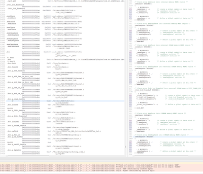

Look in the map file to see what is taking up so much space.
Probably the mem2mapbase section needs to be marked as NOLOAD.
ChaoAuthor
Senior
October 11, 2025
Thanks for reply!
Add NOLOAD and build, it does not make difference:
Here I include the map file, could you please have a look at it, as I don't have experience on it, I could only read it intuitively.
October 11, 2025
If I declare a new section like you are and mark it as NOLOAD, the program compiles for me. I'm not sure what you are doing differently. Are you sure you're modifying the right linker script? Check the linker script listed in the log file to the one you are modifying.

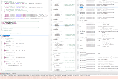

I created a very simple F767 project, specificly for this test.
The project only enabled Serial Wire, selected LSE and HSE, added all variables with __attribute__ declaration in the main.c, also initialized these variables in the main, modified linker script as in previous project, and finally build the project, and the build failed:
I found, if I don't do the initializations on these variables by commenting out the USE_VARS definition, the build is okay. Please find attached file for the whole project.
Because the modification of linker script for different variables are in the same way as shown below, could you please confirm whether or not it is correct:

TDKBest answer
October 12, 2025
