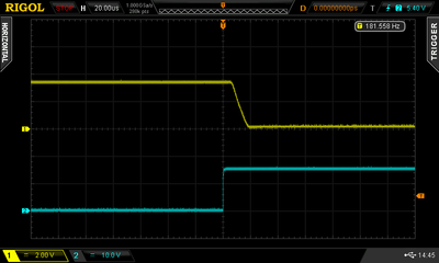

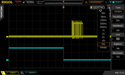

 ... and this comes out :
added: about 10us from external signal blue to cpu-pin (yellow), by opto-coupler there:
(with long persistance, to see many INT on one screen) -> some delayed a little, because other INT coming - thats clear.
And HAL_GPIO...set needs about 200ns, i tested separate. Nothing to worry about.
BUT NEVER shorter than about 50us delay, from signal to INT ! (about 10us here from circuit, with opto coupler at input; but still 40us delay from cpu , that i cannot explain.)
ed.: The (almost) 50us delay coming from opto coupler, because the rising (!) pulse is used for INT, and this is much slower than the falling (i checked with scope at first).

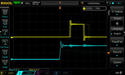

Now "correct" test on H563ZIT , at 250M core, I-cache on :
EXTI -> INT time about 120...140ns ; so about 25 core cycles, more than expected - but close.

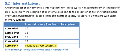

> Is the "expected" timing from NVIC somewhere given ? I didnt see in ds, rm or PM0253, Cortex®-M7 processor programming manual -- so anybody knows this ? Or is it some kind of secret info... ??
It's quite hidden. 12-14 cycles on the M7.
*Cortex-M for beginners (arm.com)
Be aware there are other things that can increase this time, such as flash wait states, cache misses, probably others.
So just the 500ns delay remains, but i will check this also, again, with other settings for stack .
But this is no "drama" . :)
