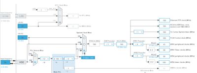

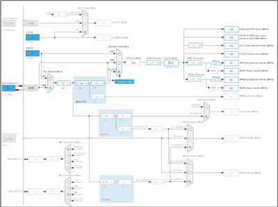

I have designed my PCB with stm32f427VIT6 and a 24Mhz crystal oscillator. I was trying to upload and test the normal blink code and it's not working. If I disable the external clock, the LED works and does not work with an external clock. I am completely new to STM, I did not know exactly whether I messed up with the design or could not configure the clock properly. I am attaching the schematics of my connection and a screenshot of the clock configuration that I have tried. Kindly help me :)

Have you tried using the debugger to see exactly where it fails with the external clock ?
When you used the internal clock, did you still have the SYSCLK at 180 MHz ?
‎2024-06-27 5:22 AM
Probably stuck and died in Error_Handler() perhaps have that flag one of your LEDs, or use the debugger.
Have code starting the HSE fail more elegantly when the crystal doesn't start.
‎2024-06-27 6:13 AM
Check the code in SystemClock_Config() using HAL_RCC_OscConfig(), perhaps add code to alternatively use HSI (16 MHz) + PLL to get the operational speed you want in case HSE fails to start.
Then debug the component choices / loading of the HSE, that precludes it starting, or start sufficiently quickly.

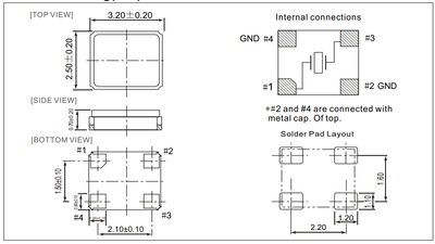

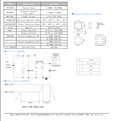

Hii.., Thank you for your reply. I have found the issue. the issue was with the oscillator only where I used the wrong one. the pinouts for the oscillator I used are different from the circuit I made. replacing the oscillator would solve the issue.
‎2024-06-28 1:44 AM
Thankyou for the response. The issue is with the oscillator only, I chose the wrong one.
‎2024-06-28 2:13 AM
One of those is an actual, active oscillator; the other is just a passive crystal !
The circuit you showed is designed for the passive crystal.
See:
