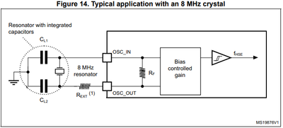

Hi All,
I need to design an PCB with STM32C011F6 (TSSOP20 package) that will have few inputs, few outputs and an ADC input (0V-3.3V).  I have seen the hardware design guide which talks about integrated oscillators of 48MHz and 32Khz but I'm not sure about if I need an external crystal/oscillator and what should be the value of it (i.e. 32KHz or 8 MHz or any other value). I intend to program it via STM32duino Arduino library.
Any suggestion will be very helpful.

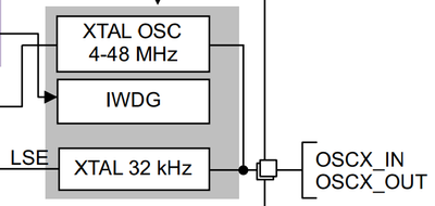

@nitin29 wrote:
Now at page 27th, the datasheet talks about pinout and points to PC14-OSCX_IN and PC15-OSCX_OUT. !
Those can serve as IN and OUT for either the High-speed internal oscillator (4-48MHz) or the Low-speed internal oscillator (32kHz) - hence the 'X':
Elsewhere in the document, they are referred to as OSC32_IN/OUT when used for the 32kHz oscillator, and OSC_IN/OUT when used for the 4-48MHz oscillator:
@nitin29 wrote:
So, what crystal value I can use so I will not have issue? Will Arduino automatically detect what clock is used or it need a specific clock (HSI or HSE or LSI or LSE) to get it program?
I don't know what STM32Duino/Arduino requires or supports - you'd need to ask on the STM32Duino forum for that:
https://www.stm32duino.com/
But, in general, for reliable UART communication you certainly should be using a crystal. Choose one which allows you to generate standard baud rates (9600, 115200, etc) within acceptable errors.

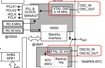

@nitin29 wrote:
having programmed STM32F103C8 generic board (comes with 8 MHz and 32KHz crystal on board)
Note that the STM32F1 had separate pins for OSC_IN, OSC_OUT (4-16MHz) and OSC32_IN, OSC32_OUT (32kHz) :
The sharing of the OSCx_IN/OUT pins is quite a new feature.

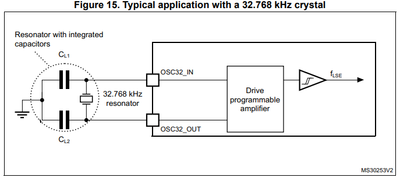

Do you mean the Application Note AN2867, Guidelines for oscillator design on STM8AF/AL/S and STM32 MCUs/MPUs ?
https://www.st.com/resource/en/application_note/an2867-guidelines-for-oscillator-design-on-stm8afals-and-stm32-mcusmpus-stmicroelectronics.pdf
Thank you very much for your link from which I now understand the difference between the two terms. Using the gained knowledge, I rephase my problem for better understanding. Correct me if I'm wrong from this point.
In the datasheet of STM32C011F6 at https://www.st.com/resource/en/datasheet/stm32c011f6.pdf
On 1st page, in clock says about crystal oscillators which I now understand that we need to provide crystal to use HSE and LSE. It also talks about HSI and LSI RC Oscillators which have tolerances. I assume that RC oscillators do not have tight tolerances that crystal oscillators can provide and therefore, should be included in cases where time accuracy is needed with minimum time drift.
Now at page 27th, the datasheet talks about pinout and points to PC14-OSCX_IN and PC15-OSCX_OUT. I assume it is talking about to provide a crystal or an external active oscillator for HSE and LSE as on page number 11 of AN5673: https://www.st.com/resource/en/application_note/an5673-getting-started-with-stm32c0-mcu-hardware-development-stmicroelectronics.pdf
