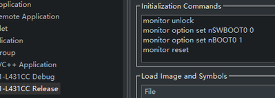

When programming an ELF file into a new STM32L431 chip(blank FLASH) for the very first time, the program does not start running automatically. It only runs correctly after a full power-off reset.
However, after this initial procedure, new ELF files can be programmed and executed directly without requiring a power-off reset.
What could be causing this issue? I recall that the STM32G0 series had a similar problem.

STM32_Programmer_CLI.exe -c port=SWD mode=UR -e all -d Test-L431CC.elf -v -rst -ob PEMPTY=0

Following CLI command just works fine:
"STM32_Programmer_CLI.exe -c port=SWD mode=UR -e all -d Test-L431CC.elf -v -ob nSWBOOT0=0 nBOOT0=1 -ob displ -rst"
with OB setting, it will force MCU start from main FLASH area.
BTW, what a pity that "Project property::Release Configuration::Startup::Initialization command" does not work.
can not find more doc on this topic.
