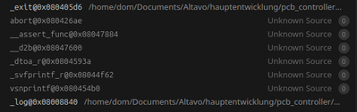

2025-01-14 6:14 AM
This is what the call stack looks like, Note "_log" is is my function which calls the snprintf. All buffers as are and big enough and the format specificer is also correct "Some float value %f". Any ideas?
