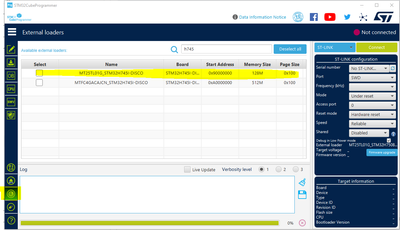

Hello @ATank.1 ,
Could you please try to use "MT25TL01G_STM32H745I-DISCO.stldr" under STM32CubeProgrammer path "...\STM32CubeProgrammer\bin\ExternalLoader".
I think it will work because the MT25TL01G_STM32H745I-DISCO" [support memory Size = 128M] for your QSPI memory and MT25QL512A [memory Size = 64MB]. So, the size of your memory is less than the external loader supported by STM32CubeProgrammer.

2024-08-12 02:19 AM - edited 2024-08-12 02:20 AM
Hi @KDJEM.1
I tried using the loader for MT25TL01G_STM32H747I-DISCO and the cube programmer connects successfully and program too is successful without any error but when I read the data the data does not match with the actual binary programmed.
Full chip erase takes only a few seconds which should not be the case. Erase sector operations are also successful but message is shown by the cube programmer that protected sectors are not erased. I think the sectors are protected maybe. Is there a way to enable them?

2024-08-13 07:56 AM - edited 2024-08-13 09:22 PM
Hi @KDJEM.1 ,
using MT25TL01G_STM32H745I-DISCO.stldr following are the observtions
1. The programming is successful but the verification fails
2. The mass erase completes in only 3 seconds which should take around 3-7 min so it is not erasing.
3. Read back programmed data and when compared to the binary, the data does not match.
4. Erasing sectors completes sucessfully but with a message that protected sectors are not erased. If data is read again after erase it is not 0xff so erasing is not happening maybe due to protected sectors
Maybe need to debug and check in code on whether the sectors are protected

2024-08-16 01:11 AM
With the Microns it's quite easy to lock the BPx bits in the status registers, especially with Macronix quad enable methods. These are situations where using the wrong loader can break things. The Mass Erase will complete immediately if and of the sectors are locked/protected
