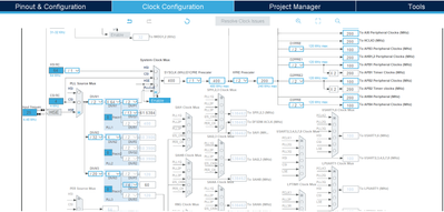

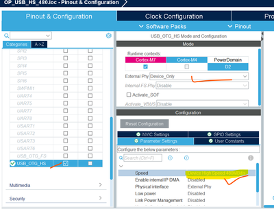

In STM32CubeMX, I have selected the USB HS mode and configured it as CDC class.
Under USB HS settings, I have selected external PHY.

I am attaching cubeide setup for reference. I appreciate any guidance or suggestions from those who have experience with external PHYs and the STM32H745.

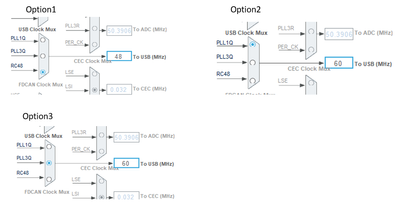

Check which clock configuration or oscillator is configured. Ensuring an accurate clock source for USB HS operation is crucial.
Best regards,
FBL
Hi @FBL
Which is the best clock configuration I should use for an external USB HS PHY with the STM32H745IIK6?
I tried both options, but with the first option (RC48), it only works if I select 12 Mbps speed with the external PHY. However, I want to use USB HS at 480 Mbps.
