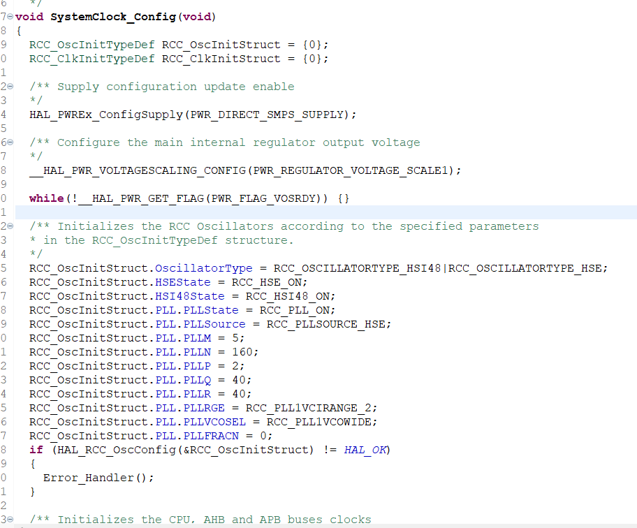

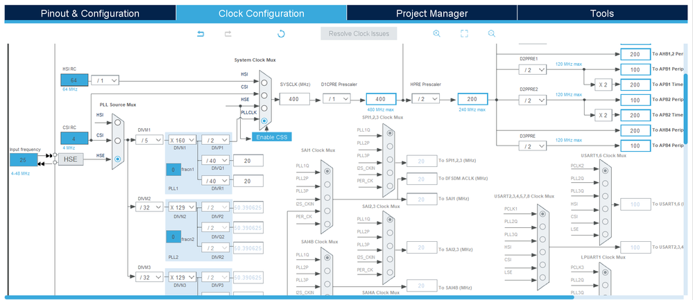

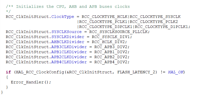

‎2022-10-18 5:45 AM
I am sharing the snap of my configuration part in these I enable the USB and GPIO . If any thing is wrong please tell me
‎2022-10-18 6:04 AM
I was trying to ask, what do you use your external clock for? If you are using it for timer interrupt is timer clock source correct?
‎2022-10-18 11:59 PM
No i am not using for the timer. HSE I set as system clock.
‎2022-10-19 12:02 AM
When I use the HSE clock for system clock, the simple LED blinking programmed not work, but when I try to generate system clock using the HSI the LED blinking programmed is start running. Why these happening.
