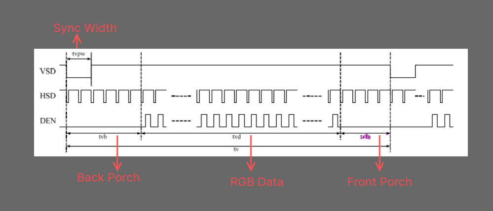

Aren't Sync and Back Porch concurrent?

Tesla and your image mean , that sync is part of accu back porch, and your nums little miss.
for example
  hltdc.Init.HorizontalSync = 4;
  hltdc.Init.VerticalSync = 4;
  hltdc.Init.AccumulatedHBP = 12;
  hltdc.Init.AccumulatedVBP = 12;
  hltdc.Init.AccumulatedActiveW = 812;
  hltdc.Init.AccumulatedActiveH = 492;
  hltdc.Init.TotalWidth = 820;
  hltdc.Init.TotalHeigh = 506;
back porch here is 8  = 12-4
your nums miss
  1. Blanking Total 370
  2. Total Pixels 1650 ...
Concurrent in my vocabulary are "at the same time", the line totals are BP+ACTIVE+FP, not SYNC+BP+ACTIVE+FP.
If the peripheral has a single pixel counter for the line, and I'm doing a compare on that count, I hold SYNC until it hits it's count, no data goes out until it hits the ACTIVE count at BACK PORCH, and stops when it hits the FRONT PORCH
