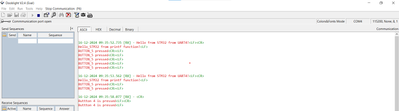

Getting back to you regarding this subject. It seems  the call of __HAL_RCC_SBS_CLK_ENABLE() was not generated by CubeMx.
Please add it manually in HAL_MspInit() in stm32h7rsxx_hal_msp.c file:
void HAL_MspInit(void)
  /* USER CODE BEGIN MspInit 0 */
  /* USER CODE END MspInit 0 */
  /* System interrupt init*/
  /* Enable the XSPIM_P1 interface */
  HAL_PWREx_EnableXSPIM1();
  /* USER CODE BEGIN MspInit 1 */
  __HAL_RCC_SBS_CLK_ENABLE();
  /* USER CODE END MspInit 1 */
 Hope that answers your question.

After loading the program, an interrupt is generated without pressing the USER button (PC13) at starting. However, after pressing the button, no interrupt is generated. It is only detected by for loop "Button 4 is pressed".

  UART_Print("Hello from STM32 from UART4!\n\r");
  printf("Hello_STM32 from printf function!\n\r");

	  for (int i = 0; i < 5; i++)
		if (buttonState[i] == GPIO_PIN_SET) // If the button is pressed
			printf("Buttton %d is pressed\n\r",i);
