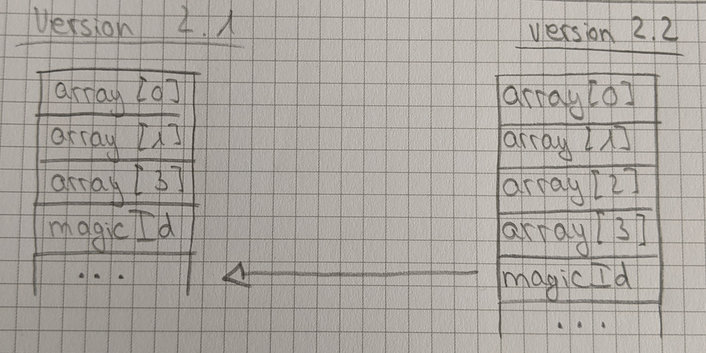

Hello everyone,
I currently have devices with a specific FW released on market. In this FW there is a structure saved in internal flash memory (with "const" and defined areas on linker file).
In the new version I am working on, I need to expand an array placed in the middle of this structure. The problem is that data next to this array will change location by doing this, what I would like to avoid.
Is there a way to add the new data of the array at the end of the structure ? Or any other idea ?
Thanks a lot for your help !

"Is there a way to add the new data of the array at the end of the structure ?"
You'd have to add another, separate array - and your code would have to cope with concatenating the two parts:
struct
original_array[ORIGINAL_SIZE];
next_item;
extra_array[EXTRA_SIZE];
"any other idea ?"
If you have plenty of Flash space to spare, Code which handles the new, bigger array just ignores the original_array, and takes everything from the extra_array.
struct
original_array[ORIGINAL_SIZE]; // No longer used
next_item;
extra_array[ORIGINAL_SIZE+ EXTRA_SIZE]; // Everything is now here

‎2022-07-05 2:01 AM
hang on a minute:
@NCatt.1​ "The problem is that data next to this array will change location by doing this, what I would like to avoid."
Why is that a problem that you want to avoid?
Surely, the whole point of a struct is that you access its members by name - so it shouldn't matter where they appear within the struct?

‎2022-07-05 3:05 AM
Because I store device configuration in this structure, and at restart I use it to reset or not the device.
If there is a new variable between 2 restarts, variables after this new will be shifted in memory and data will be lost
‎2022-07-05 3:08 AM
@NCatt.1​ ​ "This involves many changes in my code"
Then this may be a good opportunity to re-factor your code so that's no longer the case?
eg, make "getters" for retrieving stuff from your struct - then the only change would be in the "getter" ...

‎2022-07-05 3:19 AM
I don't understand, can you please elaborate more on this? Perhaps giving a simplified example? Or illustrate it with some drawing?
Are you talking about migration between old and new version of the firmware?

‎2022-07-05 4:12 AM
In both versions, at the begining there is a check of magicId, to know if the device's configuration needs to be updated (done by an app on PC). Value of magicId is always the same.
In the new version, if I expand the array, the location of magicId is shifted and does not have the correct value.
Hope it helps
‎2022-07-05 6:09 AM
That was a poor design choice, then!
magicId should be the very first thing in the struct - so that it will always be in the same place, irrespective of how the rest changes
