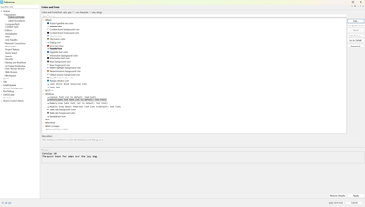

how may I change font size for Live Expressions view?
None of the options in General | Appearance | Colors and Fonts has effect.

Hello @alessandro.breuza
Can you please confirm whether you already tried the following steps?
From the menu: Window → Preferences
Navigate to:
General → Appearance → Colors and Fonts → Debug
Change one or more of these: The detail pane text font ,Modules view details..
Select the entry → click Edit… → choose the new size and font → Apply and Close.
If Live Expressions doesn’t pick it up immediately, try closing and reopening the Live Expressions view, or restarting STM32CubeIDE.
I will be waiting for your feedback.
THX
Ghofrane
alessandro.breuza
Nope, Live Expressions view does never change...
