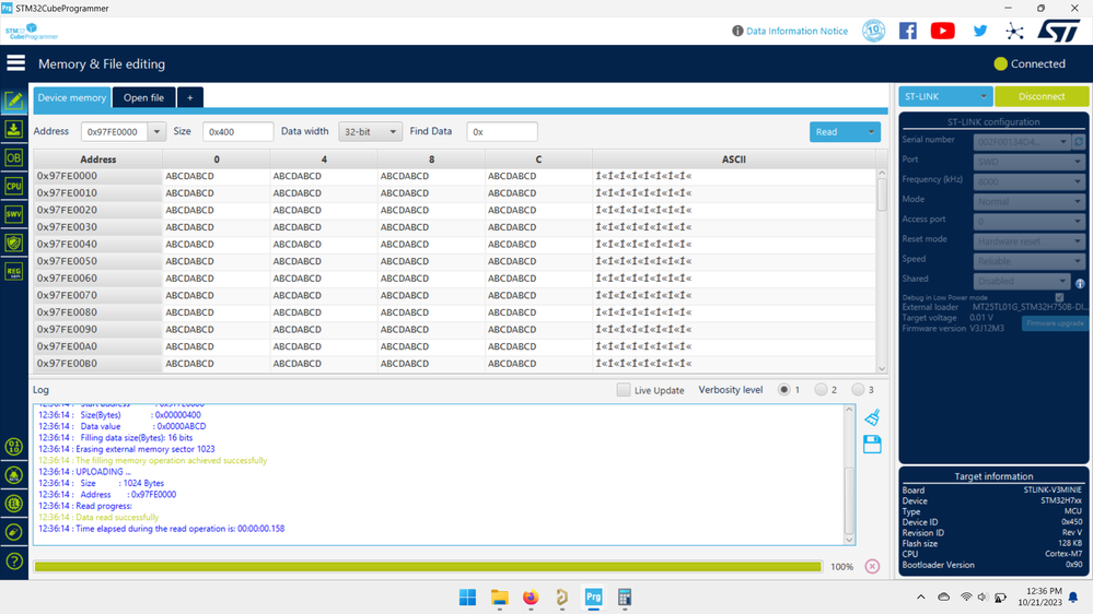

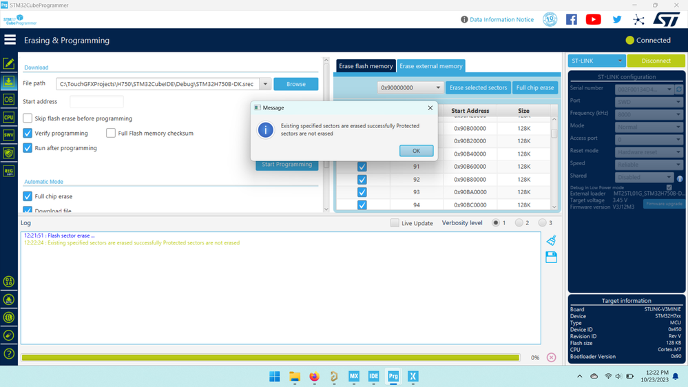

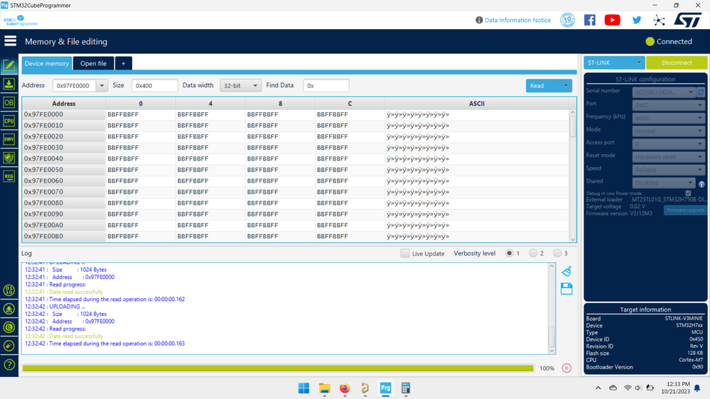

I have tried with different values and it seems to be working fine , But I tried to mass erase the NOR FLash and Got this Screenshot (30).pngI again wrote in the last memory address 0x97FE0000 and the data seems to be written perfectly fine as shownScreenshot (31).png
oh, it seems mass erase not fully functional. But as I remember, the more important is, to program code or data, the flow is erase block(s) + program block(s), random data files may be used to test if such operation is fully functional.

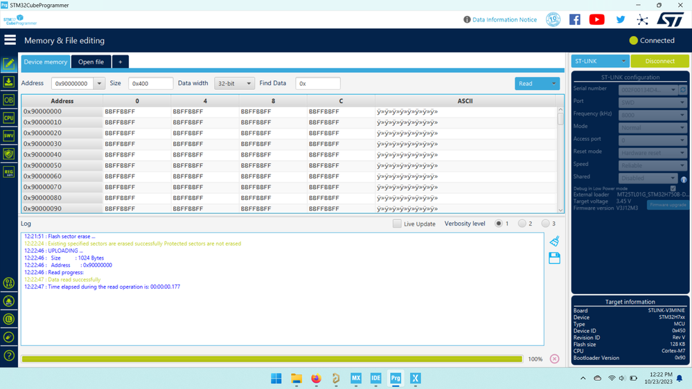

As shown in the pictures I can confirm that the data is not erased from the NOR Flash it can Only Be re written
