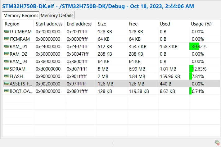

Error in Writing External Flash STM32H750B-DK
  • October 18, 2023
  • 34 replies
  • 7621 views
ST-LINK SN : 002F00134D46501420383832
ST-LINK FW : V3J12M3
Board : STLINK-V3MINIE
Voltage : 3.43V
SWD freq : 8000 KHz
Connect mode: Under Reset
Reset mode : Hardware reset
Device ID : 0x450
Revision ID : Rev V
Device name : STM32H7xx
Flash size : 128 KBytes
Device type : MCU
Device CPU : Cortex-M7
BL Version : 0x90
Memory Programming ...
Opening and parsing file: ST-LINK_GDB_server_a05624.srec
File : ST-LINK_GDB_server_a05624.srec
Address : 0x08000000
Erasing memory corresponding to segment 1:
Erasing external memory sectors [0 1]
Erasing memory corresponding to segment 2:
Erasing external memory sector 16
Download in Progress:
File download complete
Time elapsed during download operation: 00:00:10.115
Verifying ...

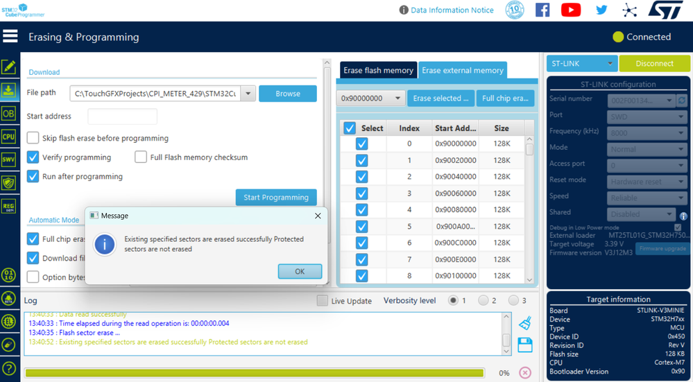

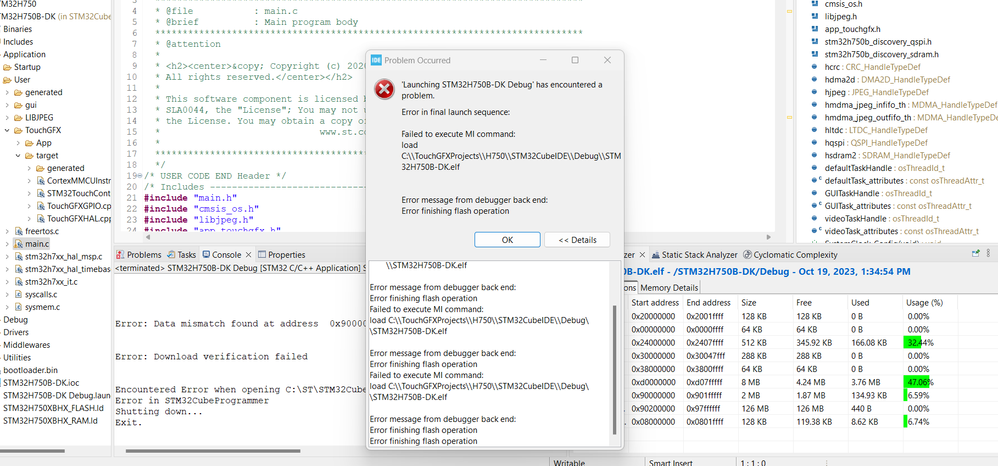

Error: Data mismatch found at address 0x90000003 (byte = 0x20 instead of 0x24)
Error: Download verification failed
Encountered Error when opening C:\ST\STM32CubeIDE_1.13.2\STM32CubeIDE\plugins\com.st.stm32cube.ide.mcu.externaltools.cubeprogrammer.win32_2.1.0.202305091550\tools\bin\STM32_Programmer_CLI.exe
Error in STM32CubeProgrammer
Shutting down...
Exit.

You may try to download and use the latest STM32CubeProgrammer v2.14.0 to see if the STM32H750B-DK is OK or not from hardware point of view.
ZExpo.1
ZExpo.1Author
October 18, 2023
Yes, I have tried that also, I re-installed everything from scratch now.
jiangfan
October 19, 2023

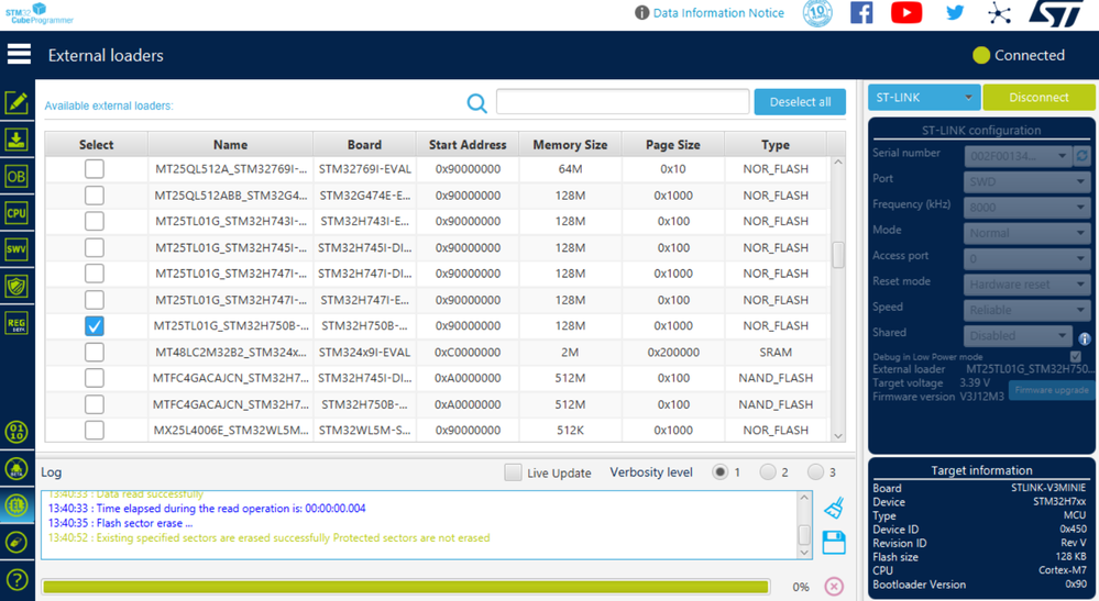

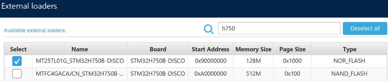

OK, be sure to enable the correct external loader: MT25TL01G_STM32H750B-DISCO for STM32CubeProgrammer to do the programming.
Tesla DeLorean
Guru
October 20, 2023
Going to observe here that if you run algorithms for other vendors devices against a Micron part that you can inadvertently lock blocks on the Micron device precluding write and erase, including mass erase, from working.
In these cases you need to remove the block protection level from the status register to recover the memory.
ZExpo.1
ZExpo.1Author
October 20, 2023
Could You please specify how to remove block protection?
jiangfan
October 20, 2023
MT25TL01G datasheet will tell you.
