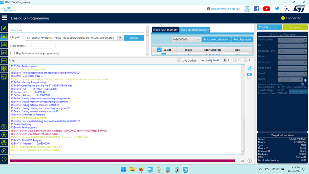

Error in Writing External Flash STM32H750B-DK
‎2023-10-18 12:04 AM
ST-LINK SN : 002F00134D46501420383832
ST-LINK FW : V3J12M3
Board : STLINK-V3MINIE
Voltage : 3.43V
SWD freq : 8000 KHz
Connect mode: Under Reset
Reset mode : Hardware reset
Device ID : 0x450
Revision ID : Rev V
Device name : STM32H7xx
Flash size : 128 KBytes
Device type : MCU
Device CPU : Cortex-M7
BL Version : 0x90
Memory Programming ...
Opening and parsing file: ST-LINK_GDB_server_a05624.srec
File : ST-LINK_GDB_server_a05624.srec
Address : 0x08000000
Erasing memory corresponding to segment 1:
Erasing external memory sectors [0 1]
Erasing memory corresponding to segment 2:
Erasing external memory sector 16
Download in Progress:
File download complete
Time elapsed during download operation: 00:00:10.115
Verifying ...
Error: Data mismatch found at address 0x90000003 (byte = 0x20 instead of 0x24)
Error: Download verification failed
Encountered Error when opening C:\ST\STM32CubeIDE_1.13.2\STM32CubeIDE\plugins\com.st.stm32cube.ide.mcu.externaltools.cubeprogrammer.win32_2.1.0.202305091550\tools\bin\STM32_Programmer_CLI.exe
Error in STM32CubeProgrammer
Shutting down...
Exit.

Ok Thanks for the input, I have set the output to .srec and tried to program as specified by you and got the following results
‎2023-10-19 2:58 AM
Your previous operation at 2nd tab was OK to erase NOR flash, you may try in that way.

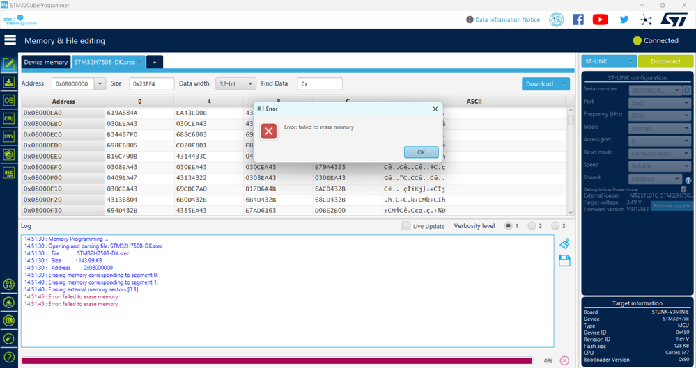

‎2023-10-19 7:35 PM
oh, almost the same status as the first post.
Well, you may try the following to avoid side effect:
1) erase internal flash
2) power down and re-power the board
3) do the programming again (I mean, previous operation at 2nd tab)
There is strange point for me: "Board : STLINK-V3MINIE". I suppose the board name information should be "Board : STM32H750B-DK".

‎2023-10-19 9:00 PM - edited ‎2023-10-19 9:02 PM
Going to observe here that if you run algorithms for other vendors devices against a Micron part that you can inadvertently lock blocks on the Micron device precluding write and erase, including mass erase, from working.
In these cases you need to remove the block protection level from the status register to recover the memory.
‎2023-10-19 9:09 PM
Could You please specify how to remove block protection?
‎2023-10-19 10:02 PM
MT25TL01G datasheet will tell you.
‎2023-10-19 10:17 PM
STM32H750B-DK uses dual MT25TL01G or MT25Q512?
