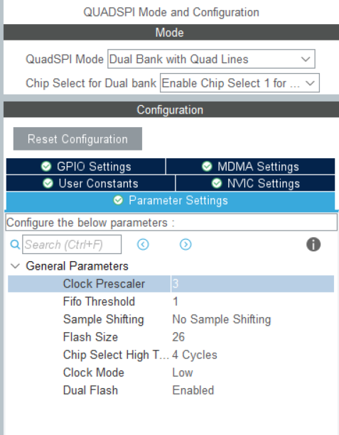

I made a bare-bone setup using https://github.com/STMicroelectronics/stm32-mt25ql512abb and setting QSPI Flash as specified in the touchgfx
I am trying to get the Flash Data but the debugger is going into hard_fault interrupt

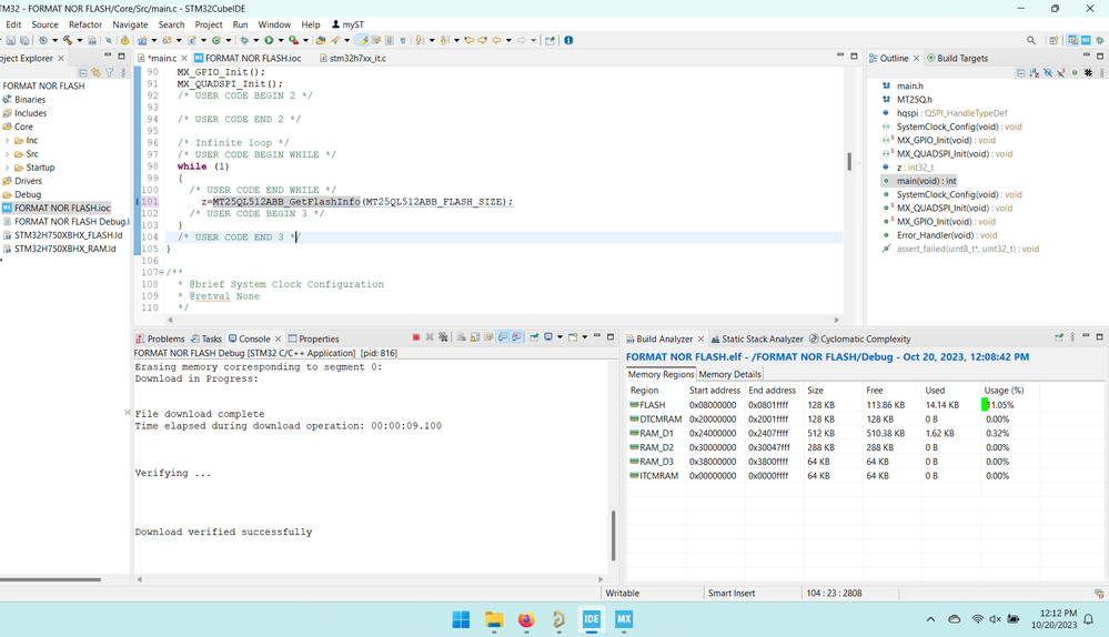

I was able to write to External Flash using STM32CUBE Programmer as shown

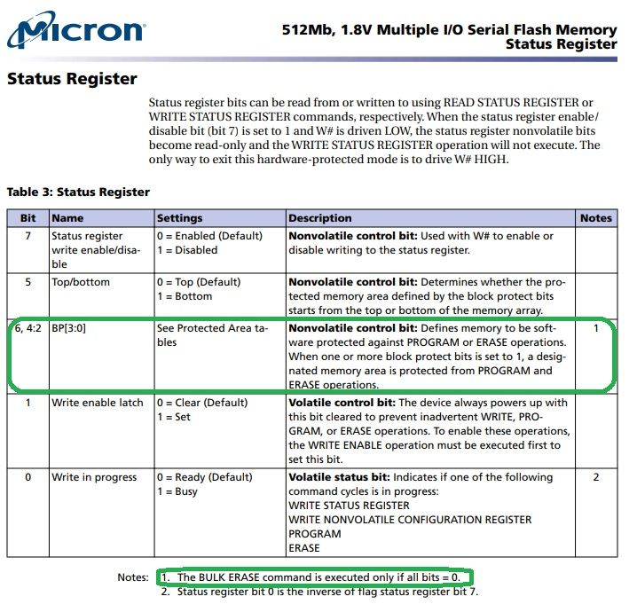

>>Could You please specify how to remove block protection?
You'd read the Status Register in the Micron device(s), clear the BP bits, and then write them back. In this dual configuration the Status Register would be a pair of bytes, and the bits in each.

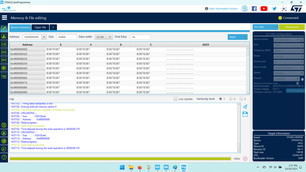

‎2023-10-20 9:53 PM - edited ‎2023-10-20 9:54 PM
this shows the nor flash not protected (8387 readout)? You may double check by writing different content and resetting the board.
‎2023-10-20 10:00 PM
I have double checked that I am available to write data on the external flash, starting address is 0x900000 and what is the ending address for flash so I can write the full flash check .
