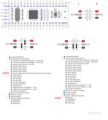

To access via USB and STM32 Cube Programmer, you need to set the BOOTx jumper pins so that the STM32F1 starts in System Loader mode.
BOOT0=HIGH, BOOT1=LOW
https://community.st.com/t5/stm32-mcus-embedded-software/boot0-boot1-pins-boot-mode-doubt/td-p/472463
The board should then present via USB as "STM32 BOOT DEVICE" or something similar, and you connect in STM32 Cube Programmer using the USB/DFU option, and not as ST-LINK

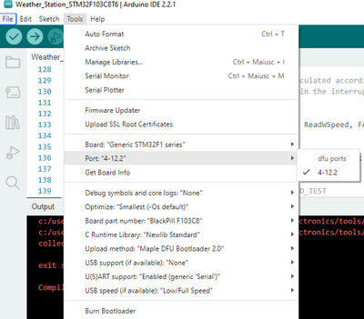

Suntchi
Many thanks everyone for your suggestions.
So, this is the situation after trying to install both the maple_mini_boot20 and generic_boot20_pc13 bootloaders, both with the BOOT0 jumper set to 1
I have never programmed a board with the STM32CubeProgrammer, I only saw online how to install the bootloader.
In the condition where the Maple 003 port is displayed on the Arduino IDE, the dfu 4-12.2 port appears but even using that I cannot program the board.
Is it possible to program it using the STM32CubeProgrammer?
Is there a guide to do this?
