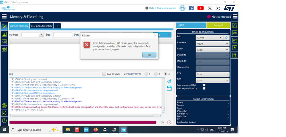

I am using stm32f103c8t6 with uart cable to connect it with stm32 cube programmer but come up the statement above. Any suggestion to fix this problem?
14:12:16 : Serial Port COM3 is successfully opened.
 14:12:16 : Port configuration: parity = even, baudrate = 115200, data-bit = 8,           stop-bit = 1.0, flow-control = off
 14:12:18 : Timeout error occured while waiting for acknowledgement.
 14:12:18 : Error: Activating device: KO. Please, verify the boot mode configuration and check the serial port configuration. Reset your device then try again...
I did press reset button and placed my BOOT0 to 1 so i really have no idea to fix this problem.

I met the same error prompt on STM32WB09KE(MB2032+MB1801D), when I try to UART programming through an actual ST-Link V3SET(as it was told here ). I tried this since I met this , my connection between V3Set and MB2032(WB09KE), pin map refer - page 27 of UM3345:
VCC      3.3V
CLK      11 - CN3
GND     GND
DIO      9 - CN3
NRST   14 - CN3
and, in Prog, I got these(the second photo was tried back by Jumper user flash):
