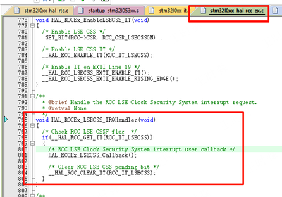

void HAL_RCCEx_LSECSS_Callback(void)
	printf("LSE CSS\r\n");
No print output was observed when the crystal oscillator was short-circuited, and debugging showed that the interrupt service routine was not entered.

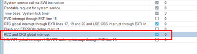

RTC_IRQHandler is not the handler for the CSS.
Is the interrupt enabled?
Should be a HAL_NVIC_EnableIRQ call somewhere. It's not in the code you presented.
Is HAL_RCCEx_LSECSS_IRQHandler defined? It's not in the code you presented.

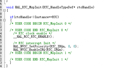

Thank you for your reply
RTC interrupt has been enabled.
HAL_RCCEx_LSECSS_IRQHandler  in the HAL library.

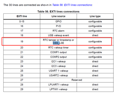

I checked the manual. CSS_LSE IT is mapped on RTC EXTI line 19.So I enabled the RTC interrupt.
I also tried to open this interrupt, but cannot be triggered.

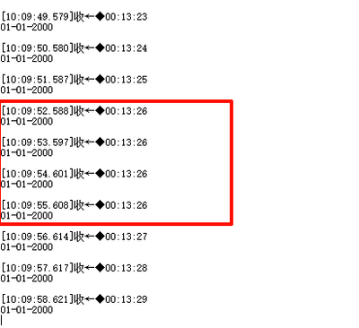

Hi,Simon
Thank you very much, I have successfully triggered the RTC CSSLSE interrupt.
