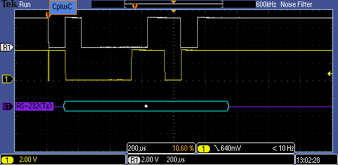

Has anyone ever used the emulated usart provided by ST (AN4457) based on timer and DMA?
I need it for transmit, not for reception.
In my test, most of the time TX characters are corrupted, sometimes it works.
I checked with scope and it appears that the startBit is missing, but the rest of the byte is correct.
Here example with the 'a', white trace is the correct one, yellow is the measured trace.
It seems that the Start bit is present in the 'calculated' buffer for DMA, but the timer overflow early...
Thank you,
Pierre

2020-07-01 6:33 PM
Try to clear TIMx_DIER.CC1DE (__HAL_TIM_DISABLE_DMA(&TimHandle, TIM_DMA_CC1) ? I don't know, I don't speak the Cube/HAL gibberish) as the first thing in UART_Emul_DMATransmitCplt().
(It's equivalent to what TDK suggested with clearing the TIMx_SR register, except that with the DMA trigger signals rather than the interrupt trigger signals
https://community.st.com/s/question/0D50X00009XkaAtSAJ/how-to-clear-pending-dma-request

2020-07-01 5:17 PM
Just prior to starting the timer, set CNT to 0 and clear the TIMx->SR flags. Sounds like an update event is pending. Just a guess.
You could also just have it set an extra start bit on the first byte for a quick hack.
2020-07-01 6:33 PM

2020-07-08 4:53 AM
Hello ,
I added the clearing of TIM_DIER_CC1DE and it works better. I inserted it just before UART_Emul_TransmitFrame()
Jan, me too I prefer working with Low level instead of HAL.
Now I'm trying to work with TIM5 instead of TIM1(already used in my project) but no signal leaves from TX pin. (stays high)
DMA, bus clk and stream have been adapted, configuration registers have the same value.
And the end of DMA (in the interrupt), I get the TE(transmit error) flag.
It seems that NDTR is not at zero when the interrupt is generated (0x9 instead of 0x12).
And it does not leave the interrupt.
Pierre
2020-07-08 5:52 AM
In 'F4, you can't use DMA1 with GPIO.
