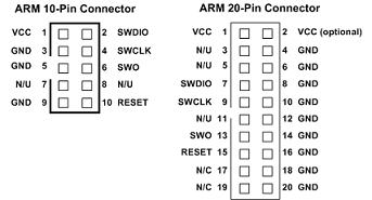

Looking at the pinouts for the 20-pin JTAG connector on the CBA being programmed, I see:
1 - 3.3V
2 - JTMS
3 - GND
4 - JTCK
5 - GND
6 - JTDO
7 - n/c
8 - JTDI
9 - GND
10 - /JTRST
11-20 - Odd pins are GND, Even pins are n/c

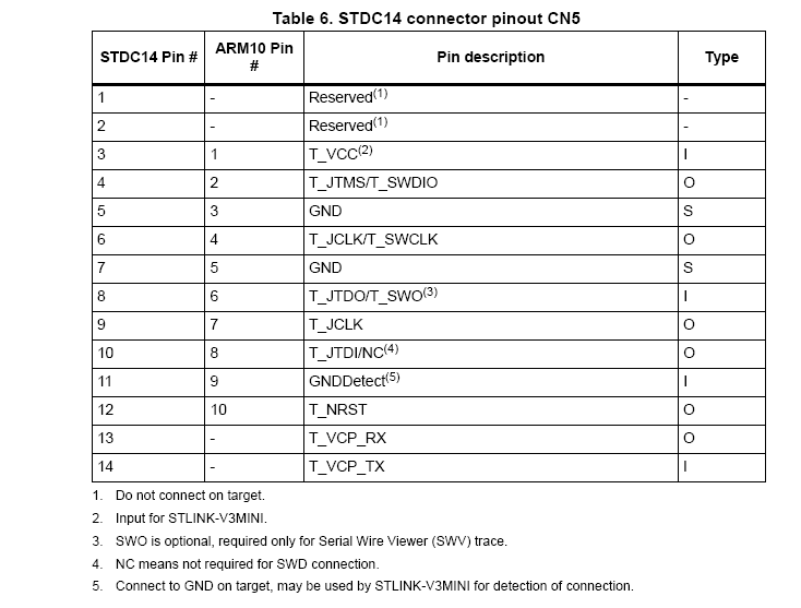

Looking at the STDC14 connector pinout for CN5 on the mini:
1 - n/c
2 - n/c
3 - T_VCC
4 - T_JTMS/T_SWDIO
5 - GND
6 - T_JCLK/T_SWCLK
7 - GND
8 -T_JTDO/TSWO
9 - T_JCLK
10 - T_JTDI/NC
11 - GND Detect
12 - T_NRST
13 - T_VCP_RX
14 - T_VCP_TX
So it appeared to me that if I just took a 10-pin to 10-pin cable, cut off one end, and replaced it with a 20-pin connector, still with pin 1 connected to pin 1, etc, it should just work. But neither STM32 ST-LINK (which is what we use with the /2 programmers, with an Olimex cable adapter) nor STM32CUBE seem to recognize the target CPU. If I swap back to the /2 with the 10-pin to 10-pin adapter, it works fine. Any suggestions?
That doesn't sound like a standard JTAG ARM connection used on the ST-LINK/V2, are you talking about the ETM Trace connector?
JTRST is not NRST
The 2mm 14-pin to 10-pin relationship on STDC vis ARM is the loss of the pair at each end.

Thanks. That was my initial thought, but I talked myself out of it for some reason. I think it was after I found this: https://1bitsquared.com/products/jtag-swd-10pin-to-20pin-idc-cable
But if I connect it the way you noted, don't I end up with JTRST connected to NRST anyway? Or are you saying "NRST" is an active-low reset, and so is JTRST? The 14-pin connector pinout came from the ST-Link "mini" document. ("Looking at the STDC14 connector pinout for CN5 on the mini:")
What I'm saying is your 20-pin enumeration is NOT for the ST-LINK/V2 header, and that JTRST is a completely different signal than the processors NRST
