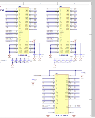

I am using a STM32H743BIT6., I am trying to access two SDRAM part-number(IS42S16320D-7TL)
problem:
both the DRAMS are wring the same data at the same time, so instead of having access to a 32 bit i am getting access to 16bit
help will be apricated
Thank you

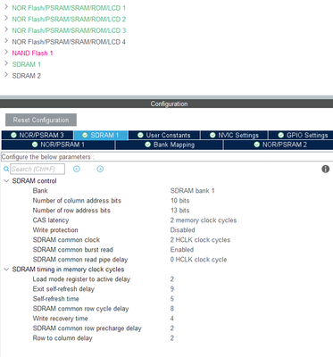

‎2023-11-03 10:15 AM
Here is the CubeMX Setting which were used for this test.
@Tesla DeLorean see if you can think of some setting which we might be overlooking here.
‎2023-11-03 10:25 AM - edited ‎2023-11-03 10:40 AM
https://www.mouser.com/datasheet/2/198/42-45R-S_86400D-16320D-32160D-258456.pdf
Suspect the banking is handled incorrectly
FMC_A14/FMC_BA0
FMC_A15/FMC_BA1
These might be usable interchangeably but I think you'll need to change the A13 pin to use A15 as a source instead.
‎2023-11-03 10:44 AM
Thanks, let me try updating that and see if that can make any difference.
‎2023-11-03 10:51 AM - edited ‎2023-11-03 10:51 AM
On the BA0/BA1 side for the SDRAM, I don't suppose which 16MB bank matters to the STM32 provided that it decodes consistently
ie, these will be functionally equivalent
BA0 = A14, BA1 = A15
BA0 = A15, BA1 = A14
In terms of modding the circuit to check, changing one wire seemed the easier option.

‎2023-11-03 12:07 PM
Hi Tesla DeLorean,
i am attaching a new png file where my A15 is connected to the SRAM. if that won't cause any issues I can modify the change.

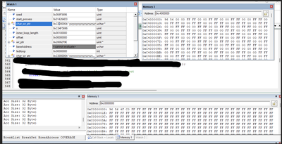

‎2023-11-03 02:06 PM
after doing the change to one SDRAM (SDRAM2) we were only able to memset to 0XFFFFFFFF half the memory of SDRAM2 as shown below
do i need to make the change for both the SDRAMS? as you mention A13 is not a bank pin
how to memset the entire memory?
when i am trying to write the SDRAM1 at address 0X0C00000. i can see that some of the data is getting written on address 0X0C10000.
