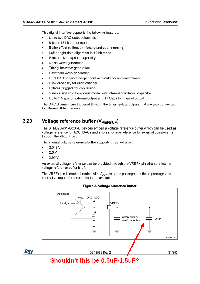

> datasheet values of capacitors
Low frequency cut-off capacitor is the one with 0.5-1.5 uF, but it requires another 100 nF capacitor to cut also the high frequency off. This is mentioned below VREFBUF characteristics, and also in the power supply diagram.
