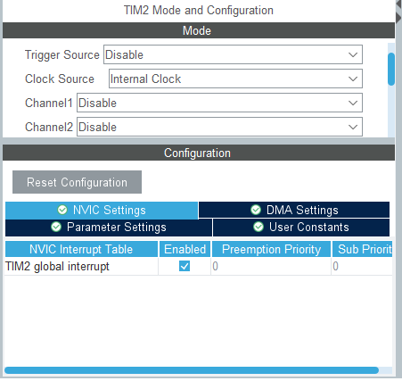

I am trying to generate interrupt every 100uSec using Timer-2 using stm32f103c8t6 blue pill. I have simply set the system clock to 72 MHz pre scaled the timer two by 72 time using 72-1 and setting counter period to 100. I have also enabled TIM2 Global Interrupt in NVIC global interrupt setting. I started this timer in main function by using following command

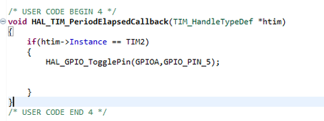

Also, I used the interrupt routine using following code where I am toggling Pin A5 on each interrupt to test the interrupt generation.

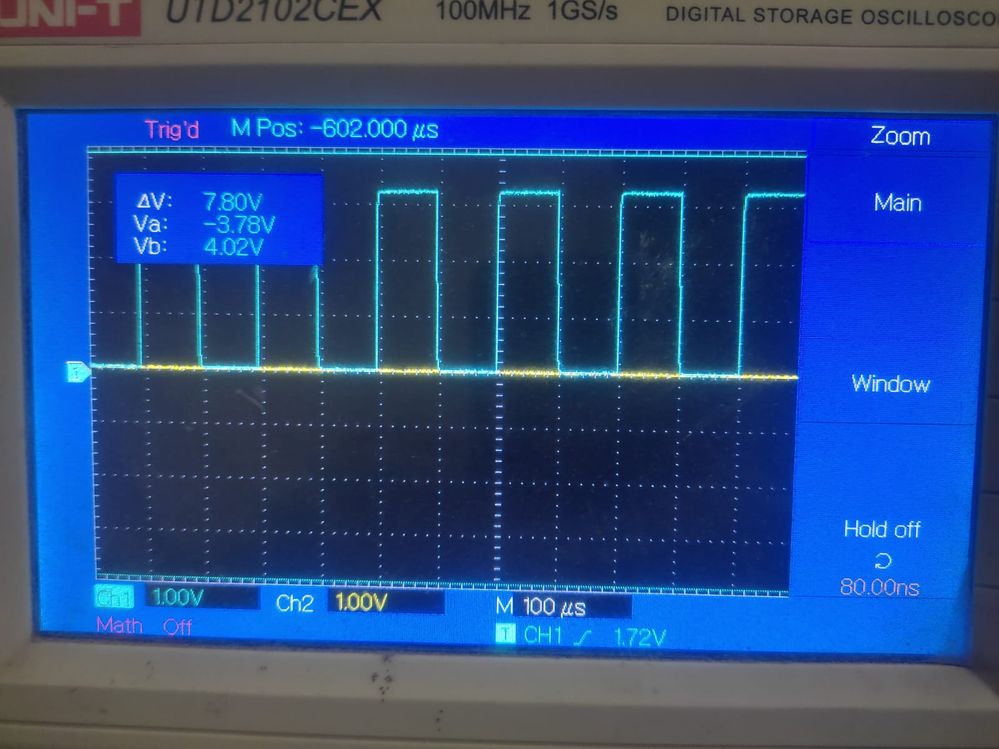

The interrupt was generated correctly as shown in the following image

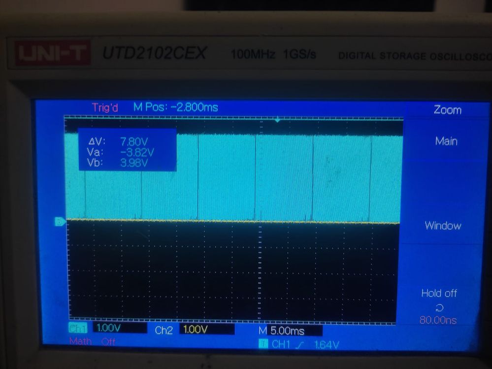

However, when I increased the time scale of oscilloscope, I found the interrupt generation is discontinuous after every 10 msec as shown below

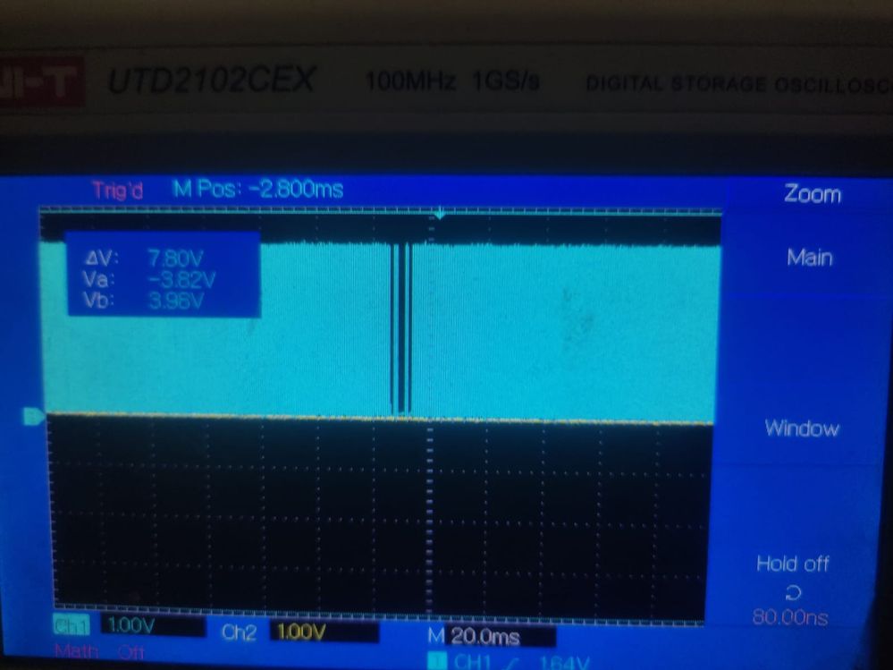

I further increased the time scale and found significant halt in interrupt generation as shown below
I am not sure what is making this interrupt generation to be discontinuous. Actually, I want to generate sine wave

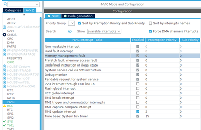

How you set the priorities of all,  esp. this INT ?

Nothing else is active in this code, I was also assuming that may be any other interrupt source may be resulting in this situation. Therefore, I started a new project where I just initialized this timer interrupt and GPIO PIN A5 to observe the interrupt. Nothing else is active.
I just enabled the global interrupt and did not set any interrupt priority as I am not using any other interrupt source.

look at the NVIC setting, to see, whats set to active and priority :
Check with scope the INT timing , but without active debug (just hard reset and run).
