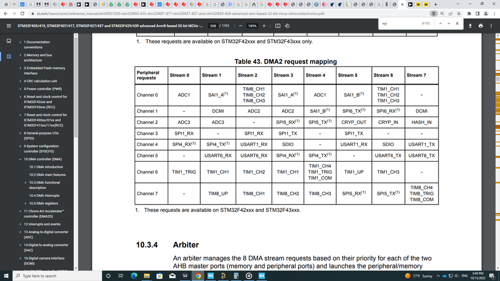

As stm32f407 reference manual said timer8 update is connected to dma2 stream 1.

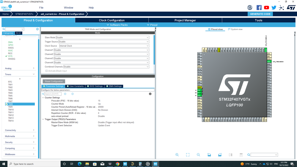

Here is the timer config by cube.

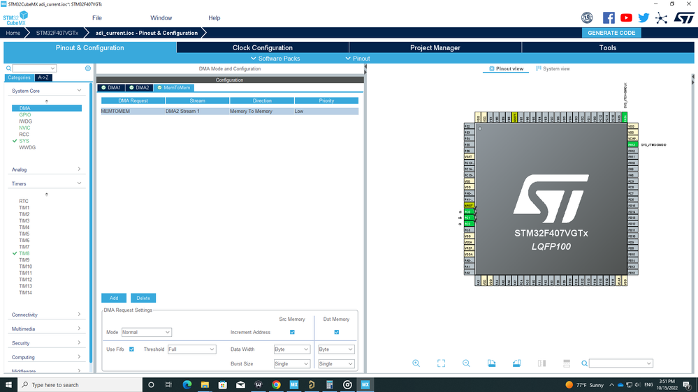

And the dma cube config:

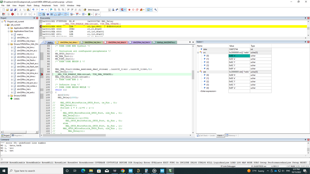

Here is the code and debug session:
As you can see the dst is not updated after timer enable.

Second, mem2mem in DMA does not mean what you think it does. DMA does not really care whether source or destination is memory or peripheral.
(DMA1 does in a way, as its peripheral port is connected only to APB1, but it still does not care what's connected there, to DMA, it's only an address as any other. But this is not important for the explanation of what you see).
The real meaning of mem2mem is, that it does not expect external trigger and as soon as you enable given stream, it will perform automatically NDTR transfers as fast as possible.
