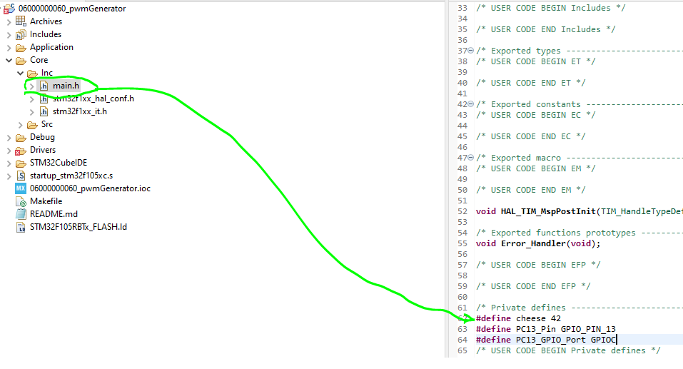

This may be a trick, but if you give the pins a user label, that label is a define you can test for.
#ifdef USART1_RX_GPIO_Port
#endif
defined in main.h
hth

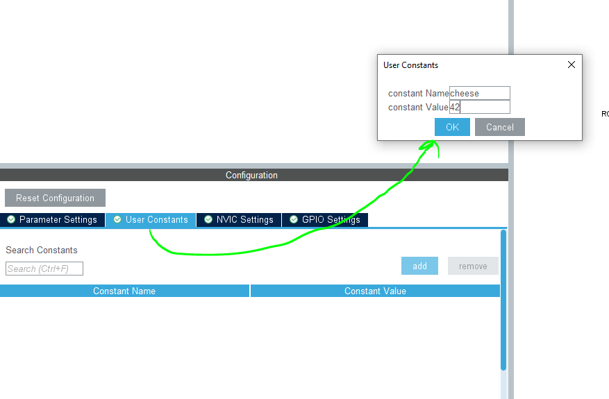

> I was aiming for solution that would work on any project, without customization; sort of library code.
You can add custom defines to Cube-generated project and make some convention with the library code.
For example you can define a UART number and baudrate that the library should use.
Also as KnarfB wrote, user-defined pin names can serve for this.

I am creating a service class for UARTs and in that class I have tables with "stuff". Sure, I could always size this table to hold all UARTs available in the MCU but that wastes memory and is ugly. What I wanted was a way, in any application that uses this class, to detect the actual number of ports "activated" in CubeMX.
‎2023-01-19 11:10 AM
I have more or less chosen that way but instead of doing all the customization in MX, I will have a Defines class included into my main class. In that way, everything is collected in a single source file.
