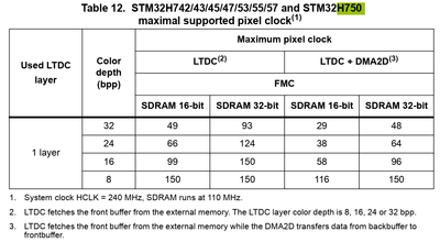

I want to design an Intuitive System with a 1280x 800 LCD interface with RGB 888 running Fluidic Animations and transitions (30FPS) Which system combination will work to create such a system? I figured it would require STM32H750 Or similar MCu with 32 BIT RAM Interface 24 Bits RGB Along with QUAD FLASH.
calculated values dot clock is in table... from this number FPS= DCLK / (1280x800) for example 16bitram 24bit dma2d FPS = 38000000/1024000 = 37FPS

I create 1280x480 DSI RGB565 on F469. Your idea is on edge for internal MCU bus capacity. You can try F7xx or H7xx  Read apnote about LTDC LCD-TFT display controller (LTDC) on STM32 MCUs - Application note

I have gone through the App note and I am some what stuck at 1280x800 Resolution at RGB 888 With 24bit Color Depth if I am running the CPU with 32 Bit RAM.
How much FPS Would I get If I am running the System with IS42S32400F-6BL in 32BIT mode
