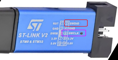

Hi everyone!
I use stm32f103c8t6 and clone st-linkv2 when i try to debug my codes with stmcubeide i had a lot of errors. Like connection error or debug path etc. I cant solve it. When i use MDK-ARM code is working but i cant get any data. Please help!

Indeed, it's not nice to use clones. But anyway as you're in a hurry: I came across a whole batch of clones which had 100 Ohms series resistors in SWCLK and SWDIO lines (a bit high, but not the primary obstacle) and with 1k2 Ohm pull-down and pull-up on SWCLK and SWDIO, respectively. Removing the 1k2 pull-down on SWCLK cured the problem.
https://www.mikrocontroller.net/topic/515218
The symptom was unreliable connection, sometimes ok for a few seconds, then breaking reapeatedly, parity errors ...
So, check for sensible resistor values.
Indeed, to be fair, I have used clones in the past and they have worked.

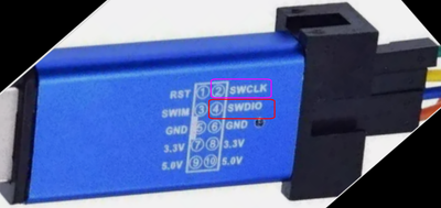

Another thing to beware of is that clones which look identical might have different pinouts!

Clones (I mean of the type shown in the pictures andrew posted) also do not provide a SWO pin (without modding) needed for "Serial Wire Viewer" (SWV) debug functionality with CubeIDE, which is a very useful feature to have during development.
