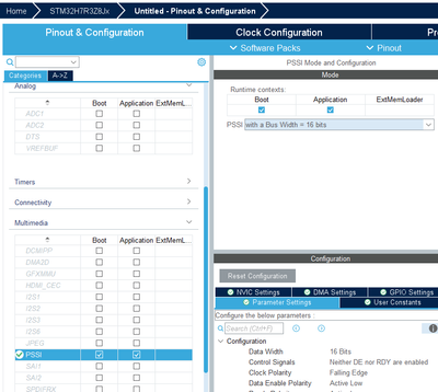

1) No matter what I do, I cannot seem to enable PSSI. The combobox is grayed out with "Disable" selected. If I mouse over, it says, "DCMI and PSSI are an exclusive choice". DCMIPP is currently disabled for both Application and Boot profiles, and the combobox if I select DCMIPP is set to "Disable". See:
My reading of the datasheet (p.21) shows the STM32H7R3Z8J6 should have a 16-bit wide PSSI available.

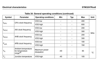

2) I cannot seem to create a power profile running at lower than 300MHz (nor is there any data in the datasheet for power consumption at lower frequencies). Is it possible to run this component at 60MHz? Should I expect similar power consumption to an STM32H5 part at that speed? (Since consumption at 300MHz on the STM32H7 seems roughly equal to 250MHz on the STM32H5)

    Hello @FA1234 and welcome to the Community :)
    Make sure to download and use the latest release of STM32CubeMX (version 6.12.0).
    I checked your use case (with STM32H7R3Z8 device) and enabled the PSSI without issue.
    You can enable the PSSI. Then set the PSSI parameters (select a 16-bit interface, hardware control signals...) from the PSSI Mode Configuration Menu.

    Dear @FA1234 ,
    Welcome in our STCommunity !
    I can not help on first question as it seems either linked to some configuration option or something like . Is that possible please for sanity check select instead a part number having the superset package in terms of I/Os that means TFBGA244 so 7R3L8xx instead in CubeMX and try again if still the same . The DCMIPP is sharing same physical pins as PSSI slave controller . I’m curious to know your use case if PSSI may be to connect an external FPGA ?
    Regarding question 2 : yes you can run for any  CPU speed even at 1MHz the system runs perfectly ( no min is set in the table ). However you can run in Low VOS to have optimized power consumption.

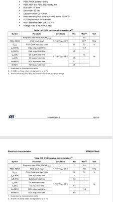

    much appreciated for the use case, indeed this  is why we implemented the PSSI for a very simple Synchronous parallel transmission using an FPGA as example, while receiving a clock from an external controller .
    Just to pay attention to always being with the right ratio of 0.4 between HCLK and PSSI_CLK, so if maximum HCLK is set to 60MHz , PSSI clock should not exceed 24MHz * 16bits data you can have 48Mbytes/s bandwidth to transmit to USB High speed . It should work perfectly.

    It turned out I did not have the H7LS package installed, but only the H7. The result was that PSSI wasn't enable-able! After installing, all worked fine. Thanks for the quick help!
