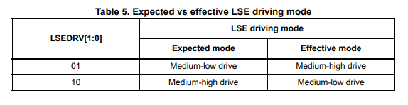

Hi @AScha.3​ ,
Based on this table from the errata sheet, LSEDRV should be set to "10" to be in the low drive as effective mode.
0693W00000WHjmgQAD.png-Amel
