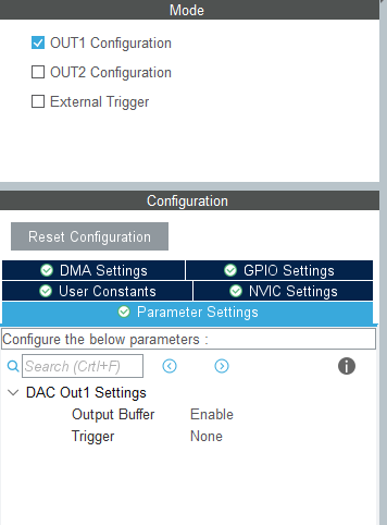

I am using NUCLEO- L152RE - Evaluation board..
used DAC 1 out:
i am not using any ADC..
just DAC1 out pin probing and checking the waveform along with output voltage.
this is configuration image
