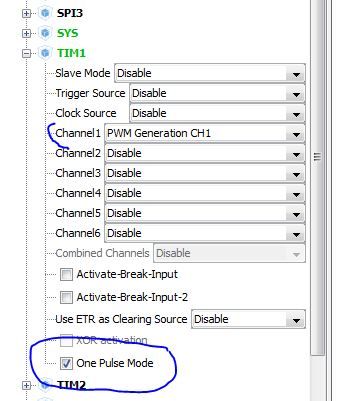

Posted on August 23, 2016 at 07:23
Some of the timers that contain multiple channels are supposed to be able to support a one pulse mode where a delay precedes the pulse after a trigger is received.  However in CubeMX I cannot see how to set that up.  Is that mode only attainable by altering the CubeMX generation after the fact with user code?
5 REPLIES 5
Walid FTITI_O
Senior II
Posted on August 24, 2016 at 13:55
Hi greenwood.greg,
You just select the channel of TIMx and after that pick the ''One Pulse Mode'' from the TIMx menu on the bottom as showed in the figure bellow.
-Hannibal-
