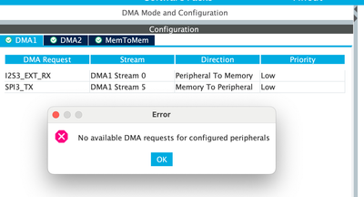

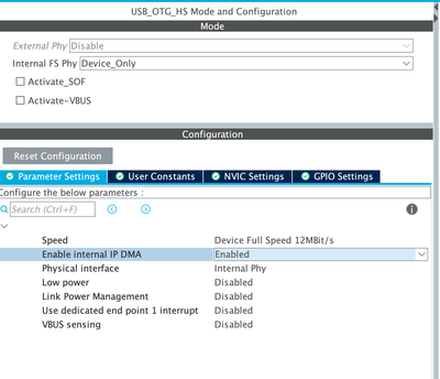

Following on from this question USB FS speed vs USB HS with internal FS Phy with DMA it seems that USB HS has access to DMA but there is no information on how this is configured. I do not see any additional DMA options appear in Cube IDE when I have enabled the above options.
Note I have enabled the option: Enable internal IP DMA

I cannot see how to configure the number 2: the Memory to USB DMA transfer
Is this configurable in CubeIDE or perhaps only in software? Given the crucial role this plays in the board's operation, I want to confirm its feasibility before proceeding. If not, I would change to a STM32 that would allow this scheme.

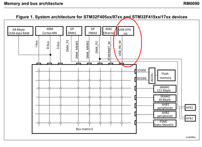

The OTG_HS module's DMA is internal to that module, i.e. it is not related to the general-purpose DMA modules.
That's why OTG_HS is a busmaster on the bus matrix.
The OTG_HS's DMA has no option to avoid increment of address, so you can't fetch data from a single address. Also there's no provision to trigger it from external trigger source like some peripheral's (such as I2S) signal.
In other words, you cannot achieve complete automatism as you've outlined. You need to use the general-purpose DMA to transfer data to RAM, and then use the OTG_HS's DMA to transfer that through USB with periodic software intervention restarting that DMA.

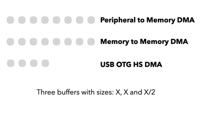

Create three buffers:

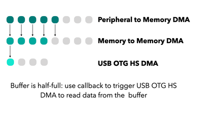

When the buffer is half full, use a callback to trigger the USB OTG HS DMA

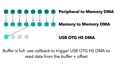

 When the buffer is full, use a callback to trigger the USB OTG HS DMA to read from the buffer at an offset:
I will use circular buffers and let this run until I have collected enough samples.
Do you see any potential issues or pitfalls with the approach? As long as all the incoming data is received and sent out without any missed bytes, this should work.
