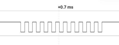

2024-08-30 7:15 AM
Created new project in CubeMX. Put the following statements in the main loop:
HAL_TIM_PWM_Stop(&htim1, TIM_CHANNEL_1);
HAL_TIM_PWM_Start(&htim1, TIM_CHANNEL_1);
HAL_Delay(100);And it gives the correct number of pulses. 11 in this case because i set RCR=10.
This is a bit cleaner with register access where all you have to do to send another pulse train is enable the timer:
SET_BIT(TIM1->CR1, TIM_CR1_CEN);
From your code:
Don't stop the PWM immediately after you start it.
From your code:

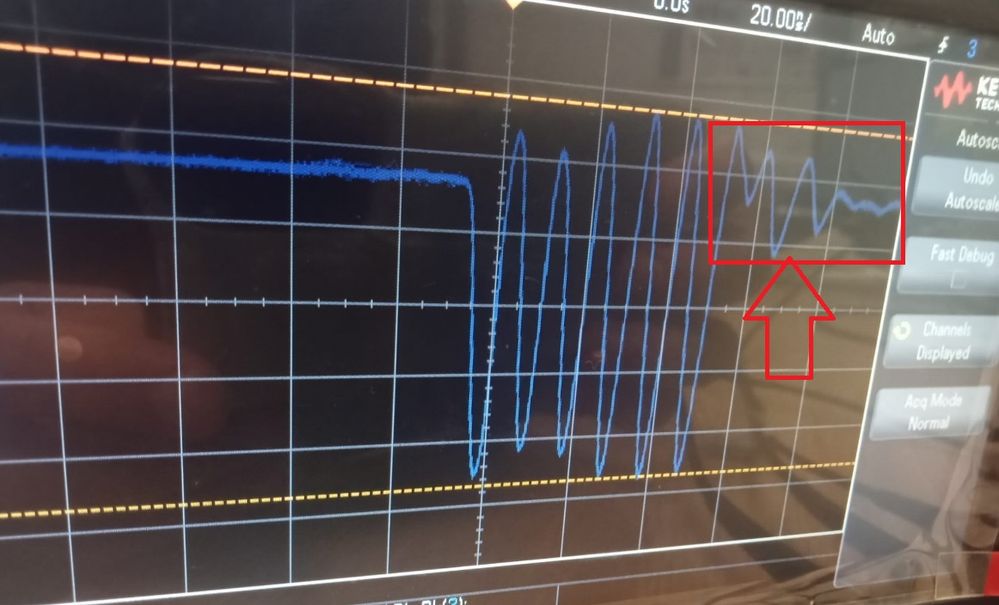

2024-09-02 3:26 AM
Indeed. if I correctly undestand that I can use only timers with RCR
Also, what do you think about fluctuation after the timer is running out?
2024-09-02 3:38 AM
That's no "fluctuation", it's called overshoot.
It's probably due to bad scope-probe setup. For frequencies > 100kHz do NOT use the probe's GND cable, but a spring tip for GND directly attached to the probe's tip.
What's the time scale of that scope pic? Can't really say if it's 20 ms or ns per division. If it's ms, then forget everything above, them you have some other circuit-related problem (load?), or configured the GPIO not correctly.
2024-09-02 7:03 AM
thank you! I measure 100 Mhz
